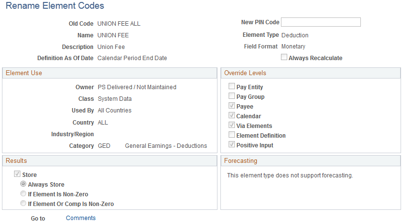

Use the Rename Element Codes page (GP_PIN_RENAME) to change an element's PIN code.
Navigation:
This example illustrates the fields and controls on the Rename Element Codes page.
Field or Control |
Description |
New PIN Code (new pay item name code) |
Enter the new code. The old PIN code is replaced when you save. Note: When renaming a PIN, make sure that you use the PIN name plus the country suffix. For example: PIN NAME DEU. |
