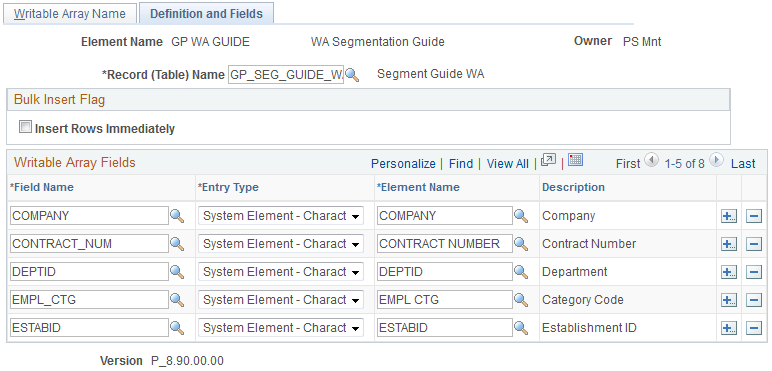

Use the Definition and Fields page (GP_WRITABLE_ARRAY) to review the writable array definition and writable array fields.
Navigation:
This example illustrates the fields and controls on the Definition and Fields page.

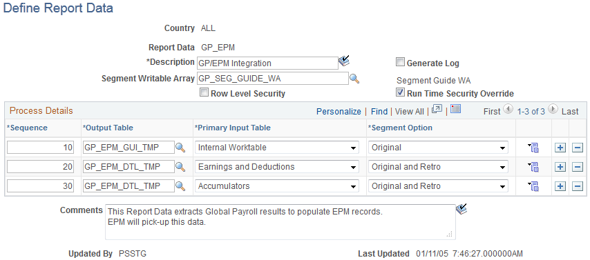

Use the Define Report Data page (GP_RPT_TBL) to assign the output table, writable array, primary input table type, and segment option.
Navigation:
This example illustrates the fields and controls on the Define Report Data page.

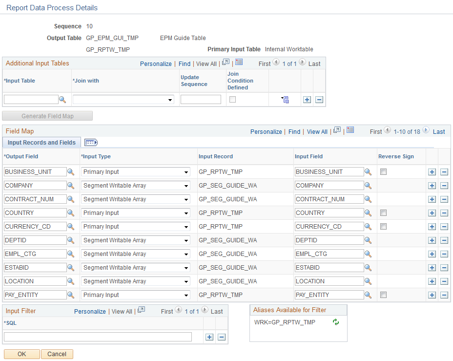

Use the Report Data Process Details page (GP_RPT_DTL_SEC) to map fields and create filters used to generate the output table.
Navigation:
Click the Details link on the Define Report Data page.
This example illustrates the fields and controls on the Report Data Process Details page.

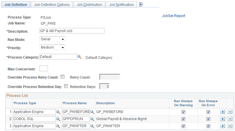

Use the Job Definition page (PRCSJOBDEFN) to review details of the GP_PAYE PSJob definition.
Navigation:
This example illustrates the fields and controls on the Job Definition page.
GP_PAYE consists of the following processes:
GP_PAYBEFORE: This Application Engine process is intended to perform any desired pre-payroll processing. It includes sections to add country-specific processing logic.
GPPDPRUN: This COBOL SQL process performs the main Global Payroll and Absence Management calculations.
GP_PAYAFTER: This Application Engine program supports post-payroll processing. It also included sections to add country-specific processing logic. In addition, this program:
Checks to see if the payroll process had been finalized successfully, and if so, calls the program that launches the Report Data process. The Report Data process populates the Global Payroll "EPM" tables with earning, deduction, and accumulator information for all processed payees.
Calls a section to extract processing monitor data if the Enable Positive Input Search check box is selected on the Installation Settings Page.
Calls a section to extract absence analytics data if the Enable Pivot Grid Analytics check is selected on the Installation Settings Page.
