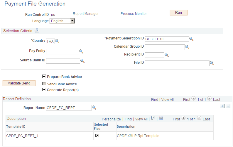

Use the Payment File Generation page (GP_FG_RUNCTRL) to send payments to Financial Gateway
Navigation:
This example illustrates the fields and controls on the Payment File Generation page.
Use this page to initiate payment requests that send payment data to Financial Gateway.
Selection Criteria
Use the fields in this group box to filter the payments that you want to send to Financial Gateway. You can filter the payments by Country, Payment Generation ID, Pay Entity, Calendar Group ID, Recipient ID, Source Bank ID, and File ID.
Field or Control |
Description |
Validate Send |
Click to ensure that the payments that meet your selection criteria have been finalized before you send them to Financial Gateway. If the selected rows are invalid, the Reason field appears on the page. |
Reason |
This field appears when you click the Validate Send button to display the reason that the selected payment rows are invalid. If the selected payments are valid, this field does not appear. |
Prepare Bank Advice |
When you select this check box, the Payment for FG (GP_PMT_FG) process identifies the rows of GP_PAYMENT_FG that meet your selection criteria and prepares them to be sent to Financial Gateway. Also, when you select this check box, the Debit Date field becomes available. Note: Subsequent runs of the Prepare Bank Advice process pick up any new rows that meet the selection criteria, but they do not affect rows that were already prepared during the first run. |
Send Bank Advice |
This check box becomes available to select only after you run the Payment for FG (GP_PMT_FG) process with the Prepare Bank Advice check box selected and successfully validate the payments using the Validate Send button. When you select the Send Bank Advice check box, the Payment for FG (GP_PMT_FG) process inserts the prepared payment rows into staging tables and publishes them to Financial Gateway through Integration Broker using the PAYMENT_REQUEST message. Note: Once you run the Payment for FG (GP_PMT_FG) process with the Send Bank Advice check box selected, you cannot cancel or resend the bank advice. |
Generate Reports |
When you select this check box, the Payment for FG (GP_PMT_FG) process generates Oracle Business Intelligent Publisher (BI Publisher or BIP) reports using the templates defined in the Report Definition group box. Note: If you select the Generate Reports check box when the Prepare Bank Advice check box is deselected, you receive a message reminding you that you cannot generate reports for payments for which you have not yet prepared the bank advice. You can, however, run the Payment for FG (GP_PMT_FG) process with both the Prepare Bank Advice and Generate Reports selected. |
