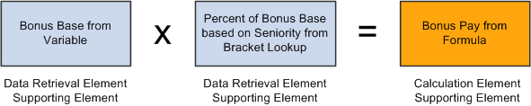

Example
Let's say that you want to calculate a payee's bonus pay. One element might be defined to contain the base bonus amount. Another element might be defined as a bracket element that retrieves the correct percentage of the base bonus based on a payee's seniority. Still another element might be defined to calculate the bonus earning by multiplying the base bonus amount (from a variable) by the percentage of bonus base from the bracket lookup to produce a bonus earning amount.
This example shows how elements relate to each other in Global Payroll.

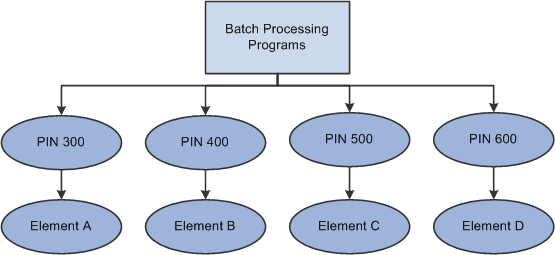

A PIN number is a numeric identifier for an element. Every element in Global Payroll has a unique PIN number, including the elements that you create and the elements PeopleSoft delivers. Global Payroll programs access and process an element by referring to its PIN number, rather than its name.
A PIN is referred to as an element in Global Payroll. A PIN and an element are identical, and a PIN number is the same as an element number. We explain the term PIN here because it is referenced throughout the programs and table structure of the application. Think of PIN as the technical name that is used in the programming and table structure and element as the functional name that is used on all pages and discussions.
This is necessary because Global Payroll is designed for use by any organization in any country. Each organization will likely give the elements that form the basis for its payroll system different names, depending on its requirements. And organizations in different countries are going to name their elements using different languages. Also, the system elements delivered by PeopleSoft are often translated into many languages. If the name were the only way to identify an element, there could be problems.
PIN numbers also improve performance within batch processes. It is more efficient for the system to use numeric values than to use character values. This performance improvement is a result of being able to easily read the numeric values into the processing arrays and create a pointer to the correct place in the array.
PINs are numbered sequentially.
Note: The system assigns a PIN number to each element that you create. The first number the system assigns is 100,001. PIN numbers prior to 100,001 are reserved for the elements that are delivered with Global Payroll.
This graphic illustrates how elements are accessed by PIN number rather than by element name.
