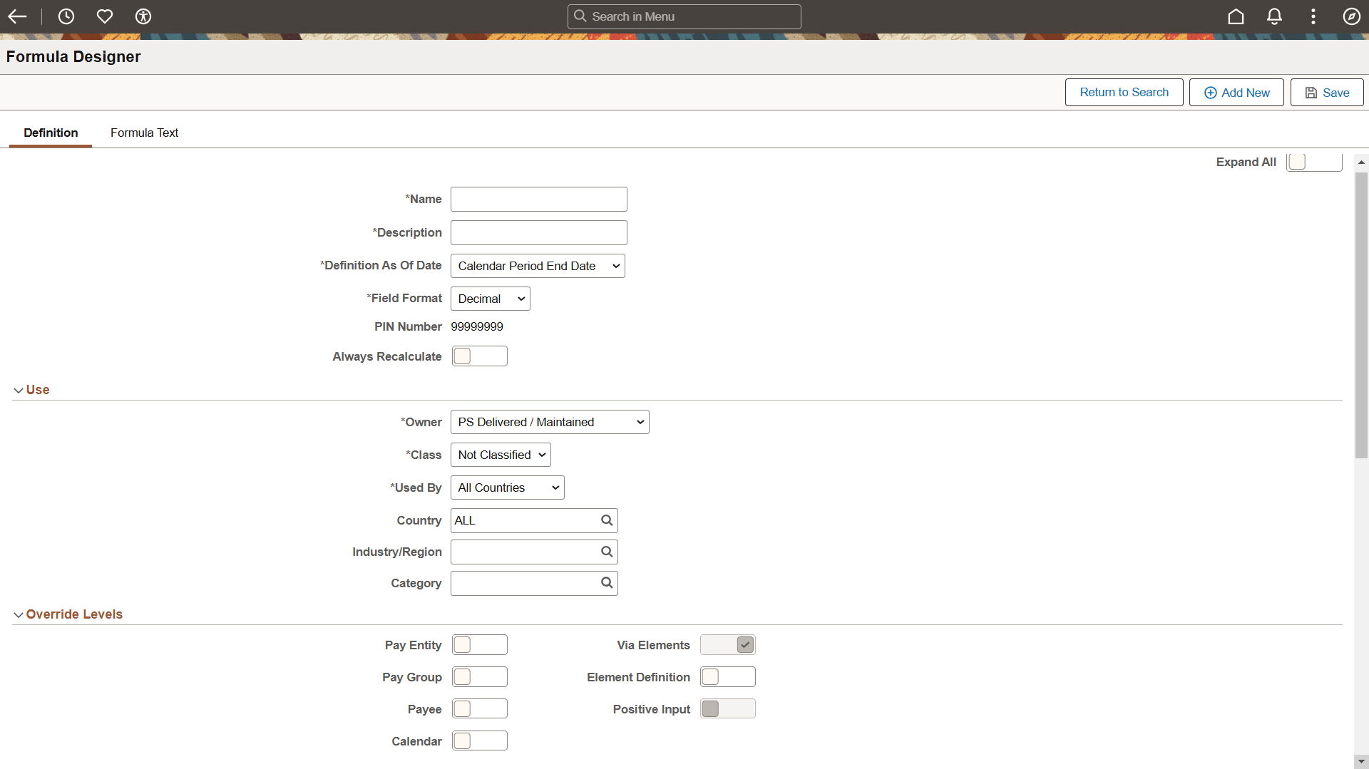

Use the Formula Designer - Definition page (GP_FRML_MAIN_FL) to name the formula element and define its basic parameters.
Navigation:
Set Up HCM > Product Related > Global Payroll & Absence Management > Elements > Supporting Elements > Formula Designer > Add New
This example illustrates the fields and controls on the Formula Designer - Definition page (1 of 2).
Formula Designer Definition page 1
This example illustrates the fields and controls on the Formula Designer - Definition page (2 of 2).
Formula Designer Definition page 2

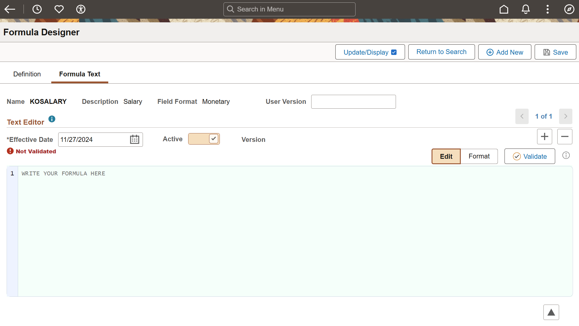

Use the Formula Designer - Formula Text page to define your formula, edit it and confirm that it's correct.
This example illustrates the Formula Designer - Formula Text page.
Formula Text2 page

Building your Formula
You can enter your formula in the text editor section. Follow the below instructions while creating or editing codes in Formula Designer.
  1. Each line of code should end with ‘;’.
  2. Remarks or Comments start with the delimiter ‘/* …. and end with the delimiter ‘*/’.
  3. Comments should be 254 characters in length.
  4. ‘>>’ should be used as an assignment operator.
  5. There should be space before and after an operator is specified.
  6. The Rounding Rule for an Element should be enclosed in brackets [] adjacent to the corresponding element to which the rule applies. For example, VR[SL VR SUPP1][GBR RR TRUNC 0DP].
  7. While defining pointers, if you intend to use element number, prefix the entry type with PTR_Elementtype. For example, PTR_ER[CH_00_72].
  8. If you are using Use Old Value for Entry Types 1 and 2, you need to add a capital O after specifying the element. For example, AC[SS AC BS CPNRM126S] [O].
  9. Literal should be tagged within single quotes.
  10. Valid operators allowed are: + ,-,*,/, =,<>,< ,>,>= and <=
  11. Valid functions allowed are IF ELSE ENDIF, SUM, AVG, MIN, MAX, AND, OR, IN, EXIT, THEN.
  12. Condition should be enclosed in () to group it as one.
  13. Append ‘;’ at the end of each statement
  14. For comment, append ‘;’ at the end of the comments delimiter, that is, ‘*/’
    Note: Spaces will be added automatically. A semicolon gets added to the end of each line automatically. (OR) The system will add spaces between words and a semicolon at the end of each line.

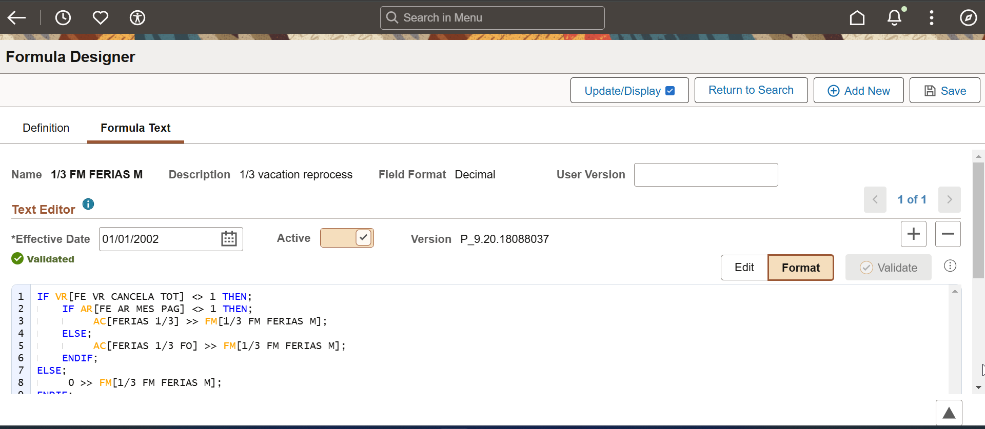

After you define your formula, save it, then validate and edit the formula. Whenever you alter the formula, re-validate it.
If the formula passed validation then you can see Validated status in the Text Editor group box as shown:
The Formula Designer page with successful validation is shown in this example.
Validated page
Note: In both legacy formula elements and Fluid Formula Designer, modified formulas will be synchronized and can be edited.

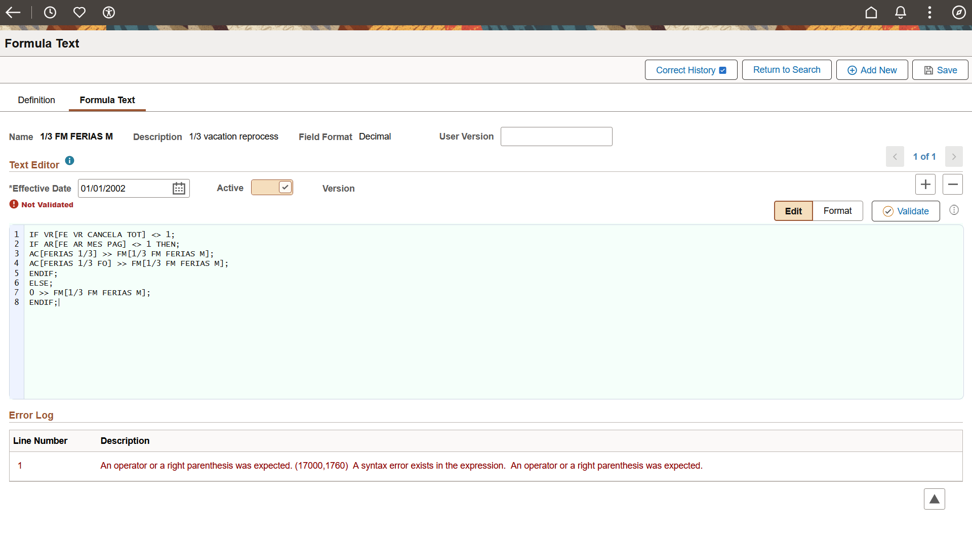

If the validation is not performed or validation fails, the status is shown as Not Validated and the formula will not be executed in the payroll.
This example illustrates the Formula Designer page with failed validation.
Not Validated Formula page
Access the Error Log section, where you can identify the specific lines where errors have occurred along with their respective causes. By clicking on the line number, you will be directed to the location of the error, allowing you to make the necessary corrections and validate once more.
