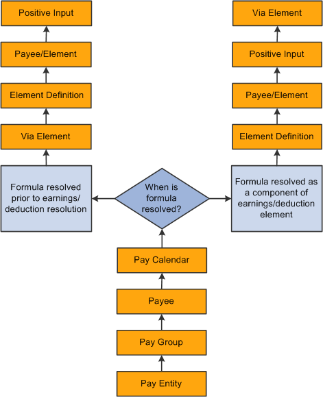

Eight override levels enable you to control the values of brackets, dates, duration, formulas, and variables:
Pay entity overrides.
Pay group overrides.
Payee overrides: Override the value of a bracket, date, duration, formula, or variable element whenever it's resolved for the payee.
Payee/Element overrides. Overrides the value of a variable used by a specific earning or deduction assigned to a payee.
Pay calendar overrides.
Via element overrides.
Element definition overrides.
Positive input overrides.
This diagram illustrates the sequence in which the system applies overrides when it encounters multiple overrides for a supporting element. It begins with pay entity overrides.
Note: A payee/element override refers to the override of a variable element associated with a particular earning or deduction for a payee. Enter such overrides on the Element Detail page, linked to the Payee Assignment By Element and Element Assignment By Payee pages. A payee override is the override of a bracket, date, duration, formula, or variable associated with a payee. Enter such overrides on the Payee Supporting Element Overrides page.
