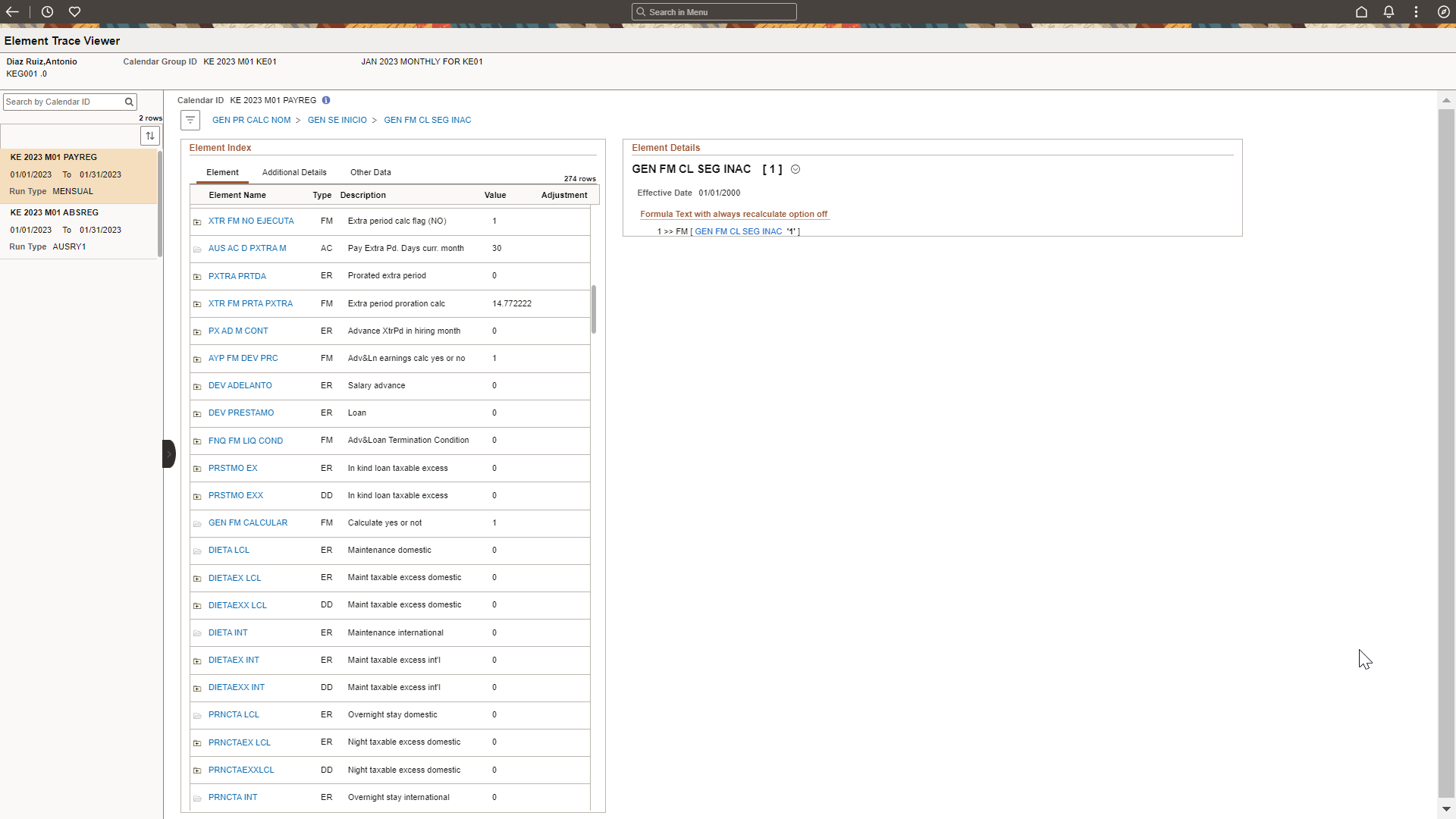

Element Index
The Element Index section includes three tabs: Element, Additional Details and Other Data. The Element tab displays the content of GP Audit table (Element Resolution Chain). By default, the elements displayed are the ones listed in the sections of the process list, however the user can drill down to get details of the elements used to resolve the element. The Additional Details tab displays the details of the elements, including the section in which the element was executed, and slice begin and end dates. You can view the Pin Number, Audit ID, Level, Sequence, Order and Time Execution in the Other Data tab.

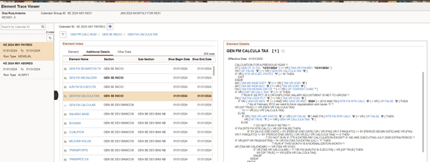

Click the Additional Details tab to view the Element Index - Additional Details page.
This example illustrates the fields and controls on the Element Index - Additional Details page.

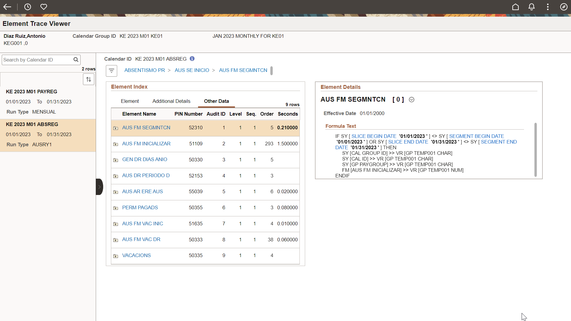

Click the Other Data tab to view the Element Index - Other Data page.
This example illustrates the fields and controls on the Element Index – Other Data page.

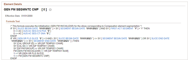

This example illustrates the details of a formula element.
System displays the text of the formula together with the resolved amounts of the used elements, which makes much easier to understand the calculation. By clicking on the formula text, users can also navigate directly to the executed elements.

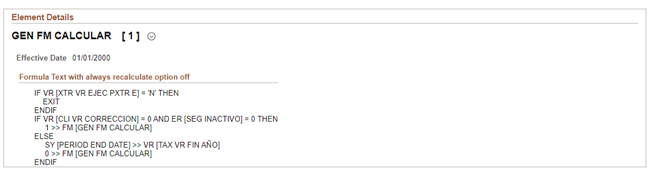

If a user selects an element that has previously been executed and has the option Always recalculate OFF, the system displays the following message: Formula Text with the Always Recalculate option off. There is no possibility to drill down into other elements because the element is not resolved while processing the parent element, the parent element uses its value but the child element is not re-calculated.
This example illustrates the Element Details with Always Recalculate option turned OFF.

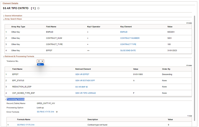

This example illustrates details of array execution.
The user can navigate to the various rows returned by the array using field instance number.

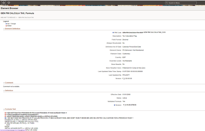

In this case system provides the possibility to Compare the setup of the selected element as it come in the file and as it is in the database where the trace has been loaded.
Result of the Compare
