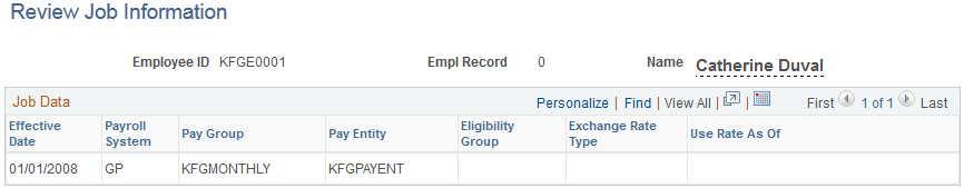

Global Payroll contains two payee data-related pages: Review Job information and Retro Limits Assignment. This topic discusses how to view job data for a payee on the Review Job information page. The Retro Limits Assignment page is discussed later in this product documentation.
Use the Review Job information page (GP_PYE_DATA) to view Global Payroll-specific information that is stored for a payee on the Job record in HR, as well as the pay entity that is associated with the pay group on the Job record.
Navigation:
This example illustrates the fields and controls on the Review Job information.
To change data that appears on this page, you must update the Job record in HR using the Job Data - Payroll page or one of the other Job Data components.
