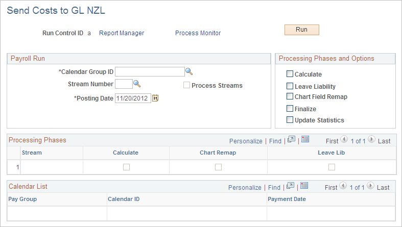

Use the Send Costs to GL NZL page (GPNZ_GL_PREPARE) to initiate the processes for calculation of GL data, leave liability, and finalization of the GLI and statistical data updating.
Navigation:
This example illustrates the fields and controls on the Send Costs to GL NZL page. You can find definitions for the fields and controls later on this page.
Note: The differences between this page and the page you access through Compensate Employees, Manage Payroll Process, Process (GP_GL_PREPARE) is the additional processing phase option of Leave Liability and Chart Field Remap.
Processing Phases and Options
Field or Control |
Description |
Chart Field Remap |
Select this check box to enable the ChartField remap application program when running the General Ledger process. This run control page enables you to run an Application Engine process (GPNZL_GL_MAP) that updates ChartFields in GP_GL_DATA. The program selects and updates the necessary GP_GL_DATA records with specified ChartField overrides. When you run the GL interface finalize process, the data is summarized using your chosen (remapped) ChartFields for correct account mapping. |
