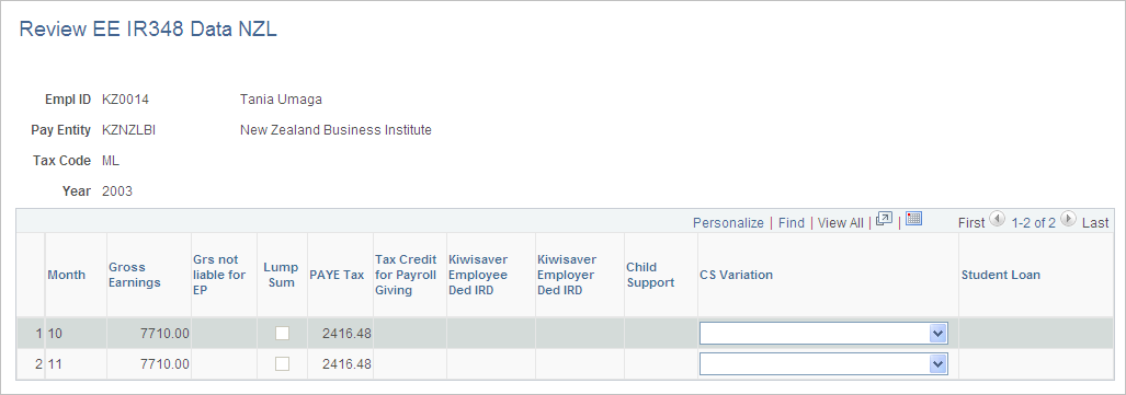

On the Review EE IR348 Data NZL page (navigation), you can view employee level IR 348 data and adjust the Child Support Variation code if required.

Use the Review EE IR348 Data NZL page (GPNZ_INQ_IR_EMPLEE) to view employee level IR 348 data and adjust the Child Support Variation code if required.
Navigation:
This example illustrates the fields and controls on the Review EE IR348 Data NZL page. You can find definitions for the fields and controls later on this page.
All the data on this page comes from the NZ IRD Details record.
Field or Control |
Description |
Lump Sum |
The system selects this check box if there is a value in EXTRA EMLMNT FMTDA (Extra Emolument - WA Reporting) accumulator for the month. |
CS Variation (child support variation) |
You can manually override the variation code if there is a value in the Child Support field. If there is no value in that field, the system displays 0 in the CS Variation field.
If the normal amount of the Child Support deduction is not the same as the amount in the month-to-date accumulator, the system determines why, using the IRD specified order of priority, and sets the CS variation code according to the conditions:
