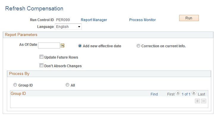

Use the Refresh Compensation page (RUNCTL_CMP015) to refresh multiple worker compensation packages with current default values, and print a report that displays the new and previous compensation data of the impacted workers.

This example illustrates the fields and controls on the Refresh Compensation page.
Report Parameters
Field or Control |
Description |
As Of Date and Correction on current Info. |
Select to update data and override information in worker records. The system updates the record that is effective as of the date you enter. |
As Of Date and Add new effective date |
Select to insert a new effective-dated row using As Of Date as the new effective date. For example, you enter 01/01/2003 in As of Date and run the process. The process inserts a new Job row with an effective date of 01/01/2003. If a record already exists with this effective date, the system inserts a row with the date and a sequence number. |
Update Future Rows |
Select to update all existing future effective-dated rows, in addition to the effective-dated row already being added or corrected. (A future effective-dated row is one that has an effective date later than the As Of Date you specify.) |
Don't Absorb Changes |
Select to leave absorbable rate codes unchanged when the defaulted salary amount changes. This option only applies to workers who have a target compensation rate and are assigned to a salary plan with the Auto Calculated Premium function enabled. |
Process By
Field or Control |
Description |
Group ID |
Select to process by group ID. The update process selects all workers with the group ID you specify. |
All |
Select to process all workers to whom you have security access. |
