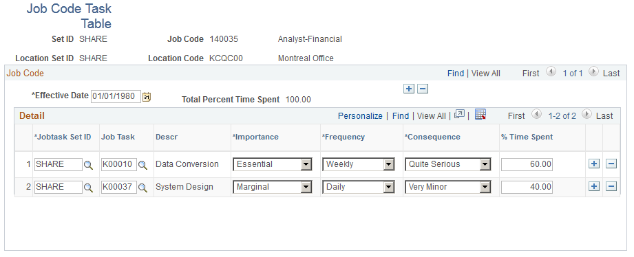

Use the Job Code Task Table page (JOBCODE_TASK_TABLE) to associated job tasks with each job code.
Navigation:
This example illustrates the fields and controls on the Job Code Task Table page. You can find definitions for the fields and controls later on this page.
Field or Control |
Description |
Total Percent Time Spent |
The system calculates and displays this when you move out of the % Time Spent field. The total cannot exceed 100%. Note: Once created, this information is particularly useful for discussing job requirements with applicants. Although the ADA prohibits you from asking applicants if they have disabilities, you can show them a job's task list and ask them if they might have difficulties in completing the tasks. This way, you offer the applicants the opportunity to describe their disabilities and any accommodations that they need to perform the job tasks. |
Jobtask Set ID |
Select a job task set ID from the available options. Valid values are stored on the TableSet ID page. |
Job Task |
Select a job task from the available options. Valid values are stored on the Job Tasks page. |
Imprtce (importance) |
Select the importance of the job task to the particular job code. Valid values are in the Translate Table. |
Freq (frequency) |
Enter how often the job task occurs for each job code. Valid values are in the Frequency Table. |
Cons (consequence) |
Select the result that occurs if the job task isn't performed. Valid values are in the Translate Table. |
% Time Spnt (percentage time spent) |
Enter the percentage of time that is spent on the job task. |
