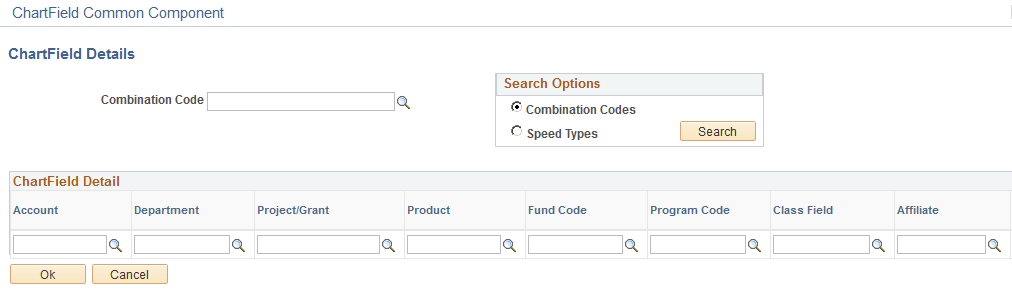

Use the ChartField Details page (HMCF_HRZNTL_CFLD) to enter or review ChartFields or combination codes in PeopleSoft HCM transactions.
Navigation:
Click the ChartField Details or Edit ChartFields link or button on an HCM transaction page.

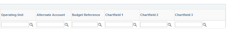

This example illustrates the fields and controls on the left side of the ChartField Details page (1 of 2). You can find definitions for the fields and controls later on this page.
This example illustrates the fields and controls on the right side of the ChartField Details page (2 of 2). You can find definitions for the fields and controls later on this page.

If the combination code is already entered on the transaction page, this detail page displays the associated ChartField values. If you are in correction mode or in a new effective dated row on the transaction page, then you can make changes to individual ChartField values and let the system determine if the new combination is valid. Otherwise the page is display only and you can only review the ChartField values.
If there is no combination code entered on the transaction page, all ChartField values are blank on the detail page and you can enter the specific ChartFields required.
Note: Only the ChartFields that are active on the Standard ChartField Configuration page are visible on this page.
Search Options
Select from the available options to search for an existing ChartField combination. The options available include the following, depending upon the combination code tables that you have set up:
Combination Codes
This option is available if you populated the Valid Combination table (VALID_COMBO_TBL).
Speed Types
This option is available if you imported SpeedType values from PeopleSoft General Ledger.

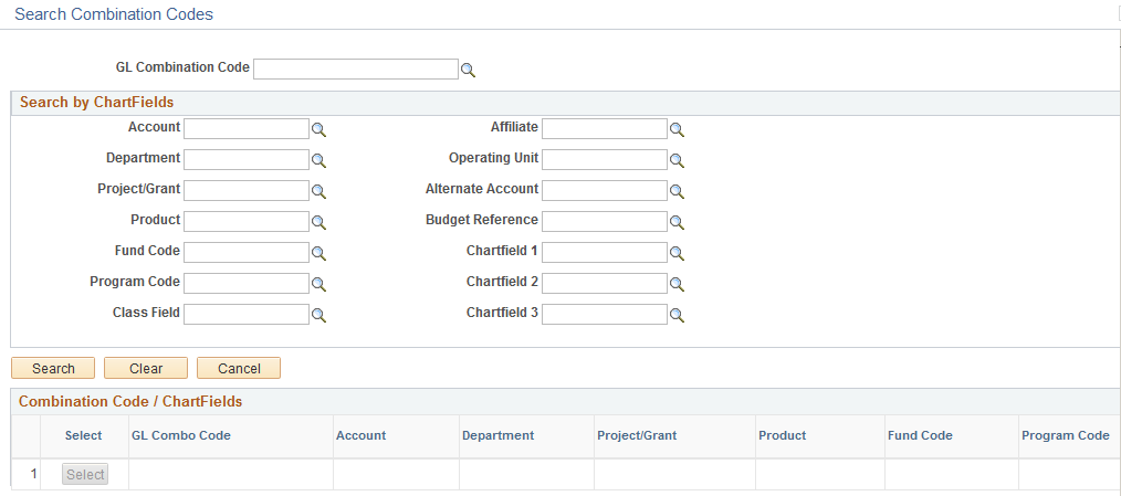

Use the Search Combination Codes page (HMCF_VLD_CMBO_SRCH) to search for ChartFields using valid combination codes.
Navigation:
Select the Combination Codes search option and click the Search button on the ChartField Details page.
This example illustrates the fields and controls on the Search Combination Codes page. You can find definitions for the fields and controls later on this page.
Note: Only the ChartFields that are active on the Standard ChartField Configuration page are visible as fields on this page.
To search for a combination code:
Enter individual ChartField values.
The system finds all ChartField combination codes that match those ChartField values.
Select the combination code that you want.
The system returns you to the ChartField Details page with all individual ChartField values populated.

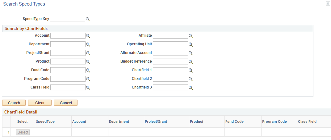

Use the Search Speed Types page (HMCF_SPD_TYP_SRCH) to search for ChartFields using PeopleSoft Financials Speed Types.
Navigation:
Select the Speed Types search option and click the Search button on the ChartField Details page.
This example illustrates the fields and controls on the Search Speed Types page. You can find definitions for the fields and controls later on this page.
To search for a combination code using Speed Type:
The system finds all speed types that match those ChartField values.
Select the speed type that you want.
Since this is selected from speed types, you might have to enter additional ChartField values to form a valid ChartField combination.
