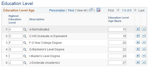

Use the Education Level page (EDLVLAG_TBL_JPN) to set up your company's education level age bases.
Navigation:
This example illustrates the fields and controls on the Education Level page. You can find definitions for the fields and controls later on this page.
The system uses these age bases in the calculation of a worker's Education Level-Adjusted Birth Date, which is, in turn, used in the calculation of the worker's Education Level Age and education level age-related pay.
Field or Control |
Description |
Education Level Age Basis |
This is the value you associate with the Highest Education Level that you selected in the first field. The system uses this in calculating a worker's Education Level-Adjusted Birth Date, which is used in the calculation of a worker's education level age. |
Note: The Highest Education Level values are translate values from the Highest Education Level table. You access the table to put workers' highest education levels on their Personal History page in Personal Information. If you change any of these translate values (inactivate them, for example), you will need to change any worker records that were using the value to use another value. If you add a translate value and you want to associate an education level age basis with it, you must also add it to this page and allocate an Education Level Age Basis to keep it synchronized with the Highest Education Level table. If you don't add it, and you use the new Highest Education Level value—in Personal Data, Personal Profile, for example—the system will not be able to calculate the worker's Education Level - Adjusted Birth Date (it will remain blank). Consequently, the system will not be able to calculate the worker's Education Level Age.

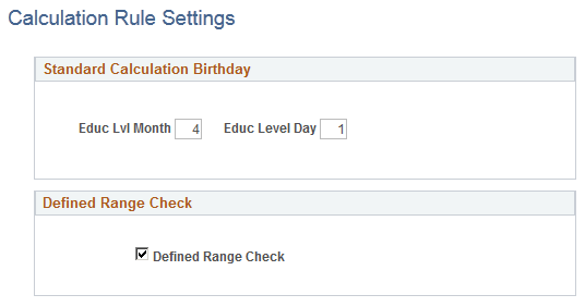

Use the Calculation Rule Settings page (SETUP_SALCOMP_JPN) to establish your organization's standard calculation birthday and specify whether you want to use a grade range check for certain salary components.
Navigation:
This example illustrates the fields and controls on the Calculation Rule Settings page. You can find definitions for the fields and controls later on this page.
Standard Calculation Birthday
This is the single date, or anniversary, on which your workers' education level ages increment by one.
Field or Control |
Description |
Educ Lvl Month (education level month) |
Enter the month, where January = 1, February = 2 and so on. This sets the month of your organization's Standard Calculation Birthday, the date on which all workers' company years of seniority increment by one year. It is used in the calculation of each worker's Education Level Age. |
Educ Level Day (education level day) |
This is the day of the month of the Standard Calculation Birthday. For example, Month 4, Day 1 sets the Standard Calculation Birthday as April 1. |
Defined Range Check |
Select to ensure the system checks that any record added to a Job Data - Compensation page with a compensation rate code of class Defined Rate of Pay (DFRPAY) is within the range that you have defined for that grade on the Salary Grade Table. The check applies to both a manually added record and an automatically added record. Selecting this check box also ensures that only one compensation rate code of the class DFRPAY can be entered on a worker's Compensation page. |

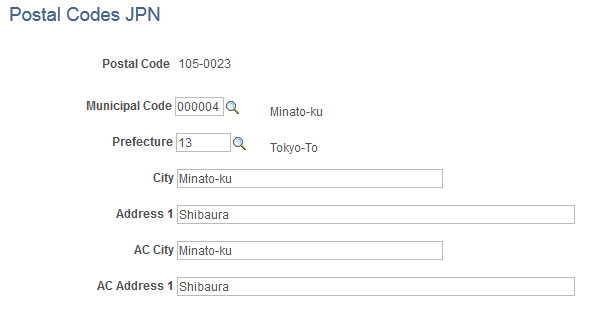

Use the Define Postal Codes JPN page (POSTAL_TBL_JPN) to enter information to maintain Japanese postal codes or add data that did not import as expected.
Navigation:
This example illustrates the fields and controls on the Define Postal Codes JPN page. You can find definitions for the fields and controls later on this page.
Field or Control |
Description |
Municipal Code |
Enter the code for the Japanese municipality that this postal code belongs to. |
Prefecture |
Select the prefecture for this postal code from the list. |
