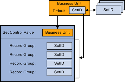

Regardless of which option you choose, when you save the business unit the system creates an entry in the Tableset Control component for that business unit and associates with each record group the default set ID you selected for the business unit. You can change the set ID assignment in the TableSet Control component.
This diagram shows the relationship between set IDs and business units and illustrates the information the system creates for the business unit in the TableSet Control component where you can change some or all of the set ID assignments:

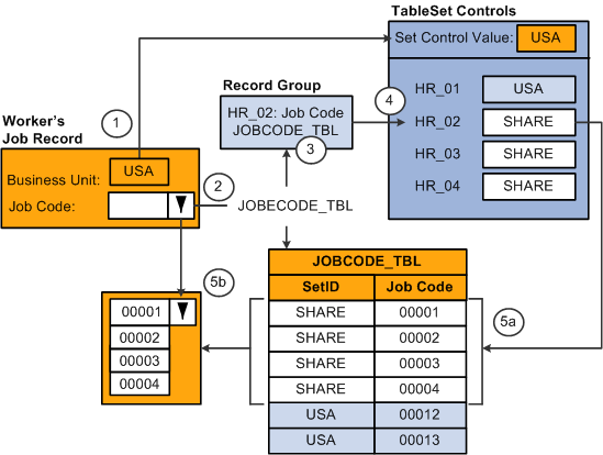

The system filters the field options available to the user in the transaction components based on the tableset controls you set up. For example, when a user is creating a job data record for a new worker and selects the drop down list for the Job Code field, the system filters the available options by determining the following:
What business unit is this person's job data record in?
USA
What table controls data for this field (Job Code)?
JOBCODE_TBL
What record group is that table in?
HR_02
What set ID is assigned to that record group for this business unit?
SHARE
What rows in the control table (Job Code Table) are keyed by that set ID?
The system looks only for the job code with the SHARE set ID values.
The system makes available to the user only the rows keyed by the SHARE set ID.
This diagram shows the tableset controls for the USA business unit and illustrates how the system determines which job code values to display for that business unit, as described above:

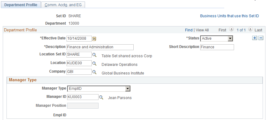

An example of a control table that is associated with multiple set IDs is the Departments component (DEPARTMENT_TBL). The record for the component, DEPT_TBL, has two set IDs: the set ID for the department and the set ID for the department's location. The set ID for the location prompt comes from the LOCATION_TBL record.
This example illustrates the Department Profile page.

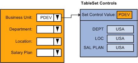

When you create a job data record for someone, you select a business unit on the Work Location page (JOB_DATA1). The system uses the business unit's tableset controls to determine which values to make available in other fields on the component and when to use established defaults.
The system only displays departments that are in the set ID selected for the business unit and defaults in the department's location only if the location is in a valid set ID for the business unit. Locations have associated salary plans, and the system defaults in the location's salary plan only if the salary plan is in a valid set ID for the business unit. If a default value is not in a valid set ID for the selected business unit, the system leaves the field blank and the user selects a value from the options in the valid set ID.

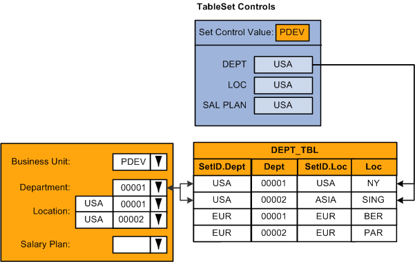

For example, in the Job Data component, select the business unit, such as PDEV as shown in this diagram. The system references the tableset controls for that business unit to determine the valid set IDs for many of the other fields on the component, such as Department, Location, and Salary Plan:

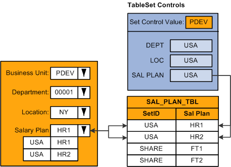

When you select the Department lookup button in the Job Data component, the system references the TableSet Control table for the record group row that determines which department set ID is available for this business unit. Since USA is the designated set ID for the department record, the system only displays in the search list those departments with the USA set ID. In the diagram below this would be departments USA-00001 and USA-00002:

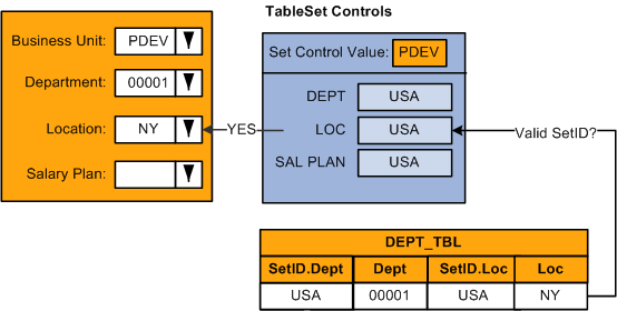

The system also checks to see if the set ID of the location associated with the department is valid for this business unit.
In this example, only locations with the set ID USA should be valid for the PDEV business unit. When the location associated with the department uses the set ID USA, such as department USA-00001, which is associated with location USA-NY, the system enters the default location in the Location field. If you were to select department USA-00002, the location associated with this department, with the set ID ASIA, will not default into the Location field. The system leaves the Location field blank:

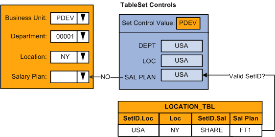

If the salary plan is associated with the location, the system checks the TableSet Control record for the business unit, in this example PDEV, to see if the set ID of the salary plan associated with this location is valid for this business unit. Since valid values for this business unit should be associated with the USA set ID, and the salary plan associated with the USA-NY location uses a salary plan set ID of SHARE, the salary plan will not be provided by default into the worker's record:
When you select a salary plan, the system will only retrieve those rows from the Salary Plan table that begin with set ID USA, as defined on the tableset controls for business unit PDEV:
