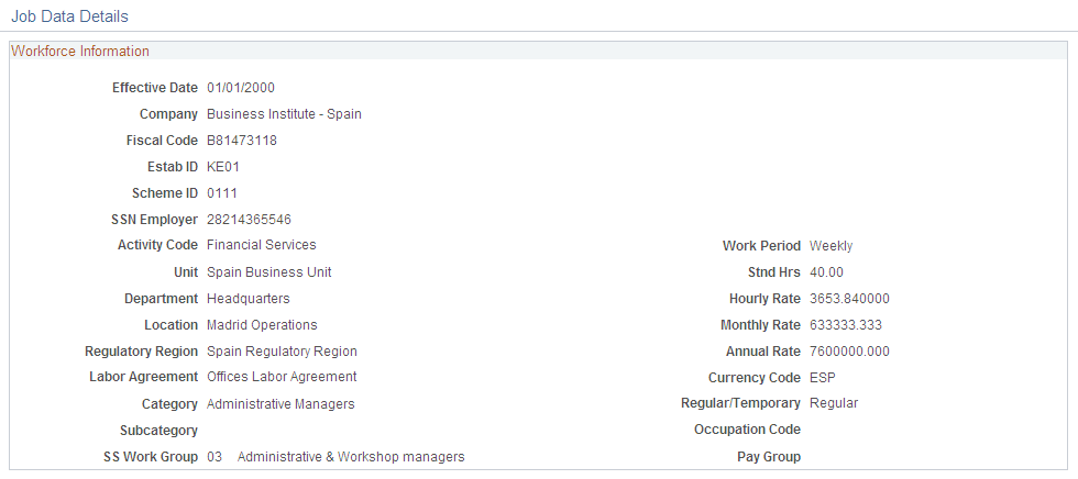

Job Data Details Page
CONTRACT2_SEC_ESP
View the job data details of the contract.

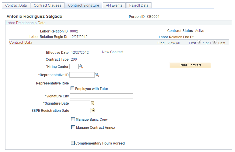

Contract Signature Page
CONTRACT3_ESP
  • Add or update the contract signature information.
  • Manage Contrata communication.
  • Print a contract.

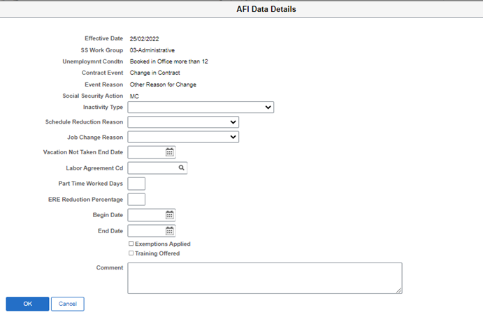

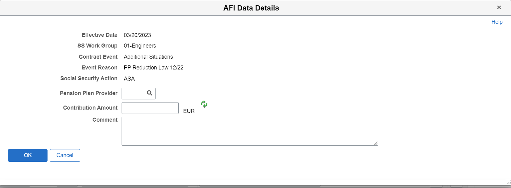

AFI Data Details Page
CONTRACT4_SEC_ESP
View or update AFI event details.

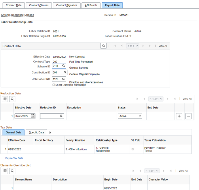

Payroll Data Page
CONTRACT5_ESP
Add or update payroll details for GP Spain customers.

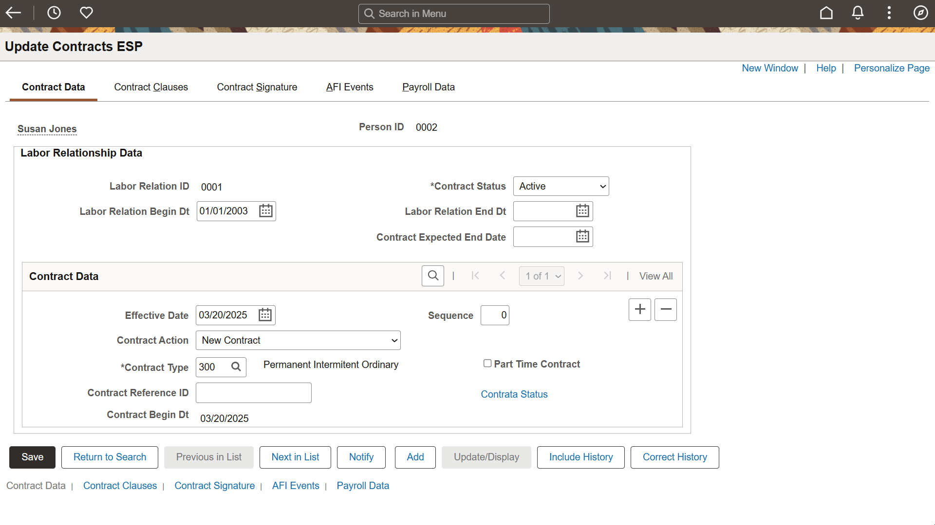

Use the Contract Data page (CONTRACT1_ESP) to add or update basic information about the contract between your organization and a worker, including the contract duration, type and content.
Navigation:
Workforce Administration > Job Information > Contract Administration > Update Contracts ESP > Contract Data
This example illustrates the fields and controls on the Contract Data page. You can find definitions for the fields and controls later on this page.
Contract Data page
Labor Relationship Data
Field or Control
Description
Labor Relation ID
Displays the identifier of the labor relationship to which the contract is being associated. A person can have multiple labor relationships with the same organization during different period of time, and each of them has separate contracts defined in the system.
Contract Status
Indicates whether the contract is Active or Inactive.
Part Time Contract
Indicates whether the permanent intermittent contract has been signed in full or part time mode.
This field is displayed for contract types 3xx and 990. For the rest of contract types, its setup specifies if it is part time or full time schedule.
Typically, this flag aligns with the Full/Part-time designation in the Job category; however, discrepancies may arise for employees on full-time contracts who adjust their schedules due to childcare responsibilities.
Labor Relation Begin Dt
Enter the date on which the labor relationship between the person and the organization begins.
Labor Relation End Dt
Enter the date on which you expect the labor relationship to end.
Contract Data
Field or Control
Description
Effective Date
Enter the date from which the contract is effective.
Contract Action
Select the action you need to perform. The possible actions are:
  • New Contract: Select this action to initiate a labor relationship. This action must be communicated to all Government agencies like Social Security (using AFI), Employment Agency (using Contrata), Unions (using Basic Copy of the contract), and also to the employee (using the Official Template Contract).
  • Extension: Select this action when the employee signs an Extension contract. In this case, you need to communicate the extension details to the Employment Agency using Contrata. This option is possible only for contract types that are of fixed duration and has extensions allowed.
  • Termination: Select this action to end or freeze the labor relationship. On termination of a contract, a communication must be sent to Social Security using AFI. For AFI reporting, the Termination Date is the first day in the new situation.
  • Calling: Select this action to communicate to Employment Agency using Contrata and AFI. In such cases, the employee must sign the calling contract. This option is available only for Permanent Intermittent type of contracts.
  • End Calling: Select this action when the Calling contract ends. You can select this action only after an action of calling. For Intermittent-Permanent contracts, the activity period starts with the Calling action, and the inactivity period starts with the End of Calling action. Both these actions (Calling and End Calling) must be communicated to Social Security using AFI
  • Remote Working Agreement: Select this action if the employee starts to work remotely under the organization's remote work policy. The Remote Working Agreement can be entered on the same date as the Contract begin date, or any other date after it. If the remote work begins on the contract start date, then the Remote Working Agreement information will be included in the basic copy of the contract. For remote work commencing after the contract start date, you will need to generate a copy of the basic contract as well.
    Note: By selecting this action, a link Remote Working Data is displayed.
Contract Type
Select the type of legal contract to be associated with the employee. The contract type determines the contract’s characteristics. The fields on the next page change depending on the type of contract you select in this field. The values selected in the Contract Action and Contract Type fields decide the fields populated in the page.
Contract Reference ID
Enter the unique identification number of the contract provided by the Spanish authorities. This field can be edited only while creating a new contract.
Contract Begin Dt
Contract End Dt
Enter the date on which the contract is expected to end. This field is not available for permanent contract types.
Total Contract Duration
Displays the duration in years, months and days of the contract based on the dates mentioned in the Contract Begin Dt and Contract End Dt fields. This field is not available for permanent type of contracts.
Contrata Status
Click this link to track the Contrata communication status. This opens the Contrata Status ESP page.
Extension Begin Dt
Displays the effective date of contract extension. This field is visible only when the contract action is extension.
Extension End Dt
Enter the date by which you expect the extension to end. This field is visible only when the contract action is extension.
Extension Number
Displays the ordinal of the contract extension. Example values are First Extension, Second Extension, etc.
Extension Duration
Displays the duration of the contract based on the Extension Begin date and the Extension End Date. The field displays the duration in Years, Months and Days, but is not available for permanent type of contracts.

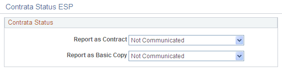

Use the Contrata Status ESP page (CNT_CTTA_SEC_ESP) to manage the communication being sent to the Employment Agency using Contrata.
Navigation:
Click the Contrata Status link on the Contract Data page.
This example illustrates the fields and controls on the Contrata Status ESP page. You can find definitions for the fields and controls later on this page.
Field or Control
Description
Report as Contract
If you are communicating information about newly created contracts, select the Contrata status in this field. The values available are Not Available, Not Communicated, XML Generated and XML Sent/Confirmated.
Report as Basic Copy
If you are communicating clauses of an existing contract, select the Contrata status in this field. The values available are Not Available, Not Communicated, XML Generated and XML Sent/Confirmated.
Report as Extension
If you are communicating extensions of an existing contract, select the Contrata status in this field. The values available are Not Available, Not Communicated, XML Generated and XML Sent/Confirmated.
Note: If the Contract Action selected on the Contract Data page is Extension, this is the only field available on the Contrata Status ESP page.
Report as Transformation
If you are communicating transformation of an existing contract, select the Contrata status in this field. The values available are Not Available, Not Communicated, XML Generated and XML Sent/Confirmated.
Note: If the contract type selected in the Contract Data page is eligible for transformation, the Contrata Status ESP page displays the fields: Report as Basic Copy and Report as Transformation.

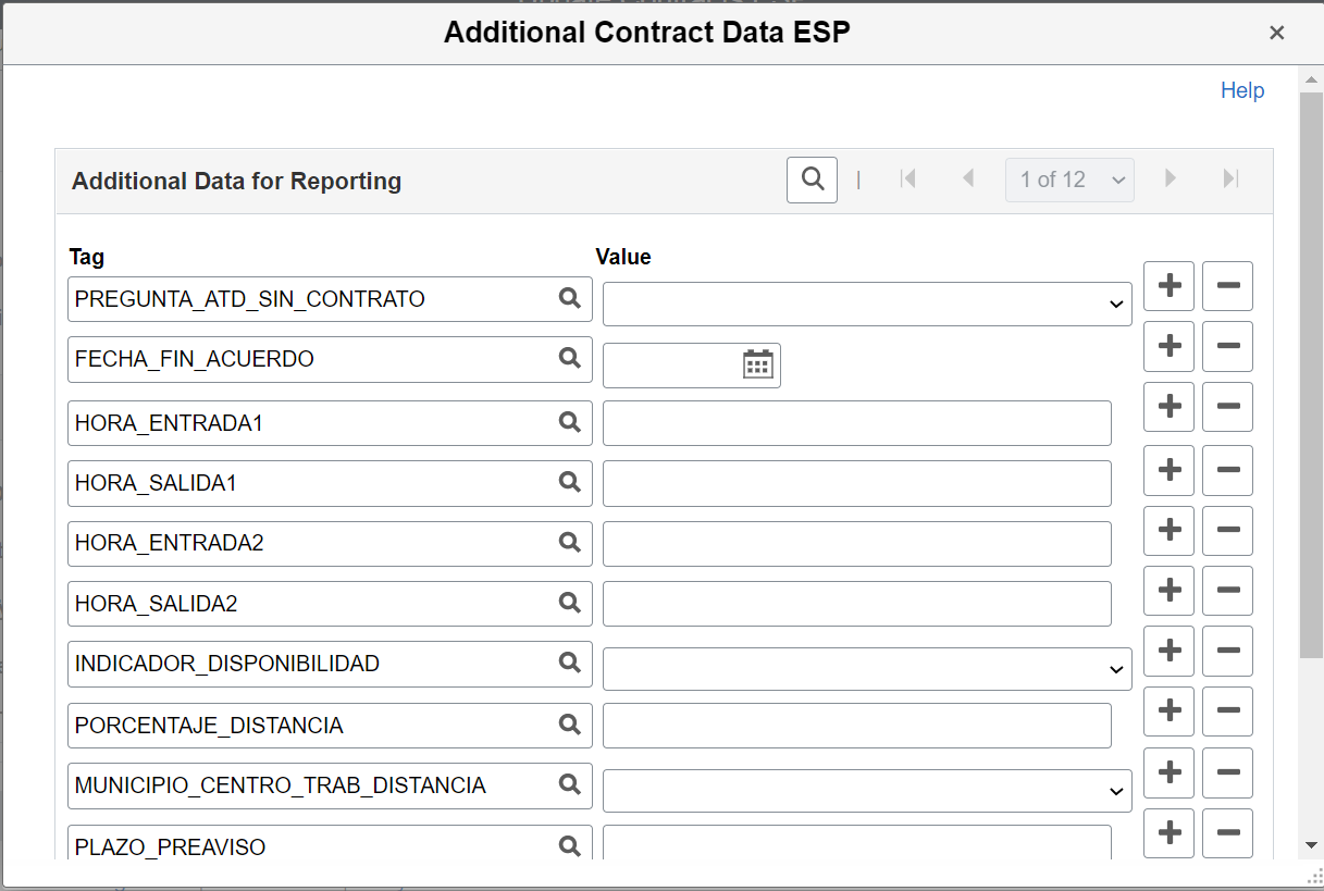

Use the Additional Contract Data ESP page to enter additional contract details required for remote working.
Navigation
Click the Remote Worker Data link in the Contracts Data page.
This example illustrates the fields and controls on the Additional Contract Data ESP page.
Additional Contract Data ESP Page
For the field PORCENTAJE_DISTANCIA, you need to enter a value with two decimals.

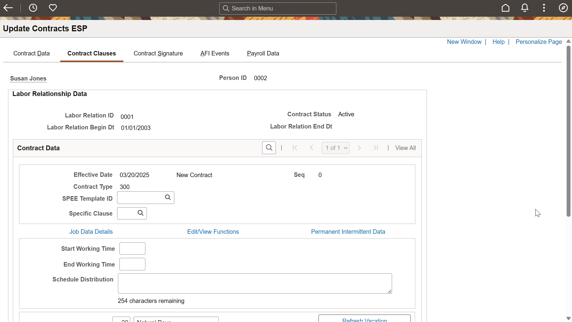

Use the Contract Clauses page (CONTRACT2_ESP) to add or update special clauses to the contract. You must have previously set up an SPEE template in the Define SPEE Templates ESP page.
Navigation:
Workforce Administration > Job Information > Contract Administration > Update Contracts ESP > Contract Clauses
This example illustrates the fields and controls on the Contract Clauses page. You can find definitions for the fields and controls later on this page.
Contract Data
Field or Control
Description
SPEE Template ID
Select the template to be used for printing the contract. This template is defined in the Define SPEE Templates ESP page.
Vacation Period
Use the two fields to specify how much vacation the worker receives per year. Use the first field to enter the appropriate quantity and the second field to select a unit of time. Units of time are Days, Labor Days, Months, Natural Days and Weeks. For example, if the vacation period is 20 work days, enter 20 in the first field, and then select Work Days from he options in the second field. Enter the vacation entitlement of the person per year as per the contract. You can enter the vacation period as Days, Labor Days, Months, Natural Days or Weeks.
Refresh Vacation
Click this button to enter the default value for vacation periods from the Labor Agreement page in the Vacation Period field.
Probation Period
If the person’s contract includes a probation period, use these two fields to specify how long it is. Use the first field to enter the appropriate quantity and the second field to select a unit of time. Units of time are Days, Months, or Weeks. For example, if the probation period is six months, enter 6 in the first field, and then select Months in the second field.
Compensation Distribution
Enter the earning details included in the compensation.
Get Job Earnings
Click this button to retrieve the Compensation details from the Job Data page. You can update the retrieved data, by either adding or removing the earnings.
Click this hyperlink to enter additional information related to the contract that will be used for the legal reporting. User can enter the information referring tot the corresponding Tag in the reporting file.
Contract Template ID
Select a contract template for the Contract Clauses. These templates are defined in the Contract Printing Mapping page. When you select a contract template ID, if the template has clauses associated, the system copies them to the below Contract Clauses scroll area. You can add, update or delete these clauses to suit the current requirement.
Tax Incentives
Select this check box if tax incentives are applicable for the contract. On selecting this check box, the page displays the Promotion Reason field, where you can select the reason for the tax incentive.
Note: This check box is visible only if you have selected a contract type that has Tax Incentives check box selected.
Contract with Bonification
Select this check box if bonifications are applicable for the contract. When you select this check box, the page displays the Bonificated Collective field, where you an select the collective for which the bonification is applicable. Bonificated collectives are applicable for specific contract types, as defined in the Define Contract Benefits ESP page.
Note: The Bonificated Collective field is available only for promotion contracts
Unpredictable Situation
Select this checkbox if the temporary contract is related to an unpredictable situation.
Duration Reason
Enter a meaningful description of the relationship between the reason for the contract and its duration.
EU Fund
Enter the description of the fund that is financing the project that justifies this temporary contract. This field is displayed only for contract types 406 and 506.
Financed by EU
Select this checkbox if the temporary contract is related the execution of a project financed by funds from European Union. This field is displayed only for contract types 406 and 506.
Project
Enter the description of the project that justifies this temporary contract. This field is displayed only for contract types 406 and 506.
Job Data Details
Click this link to access the Job Data Details page.
Edit/View Functions
Click this link to access the Permanent Intermittent Data modal window, wherein you can enter additional information of the permanent intermittent contracts.
Click this link to access the Employee Function ESP modal window, wherein you can enter information about the task that will be done by the employee.
This information is to be printed in the Clause number one (PRIMERA) of the contract.
System allows defaulting the data from the tasks assigned to the employee’s Job code.
Contract Clauses
Field or Control
Description
Seq Nbr
Enter the order in which you would like to add the contract clauses to the contract.
Clause
Select a contract clause from among those you have defined on the Contract Clause Table page. For example, a contract for a limousine driver requires that the employee have a driver's license
Clause Status
Select the status of the clause to indicate if it is Optional or Required.
Long Descr
Enter a description of the clause. The system uses this while printing the contracts.
Comment
Enter your comments regarding the clause.
Note: For contract printing, you need to select PE-170 from the SPEE Template ID field on the Contract Clauses page. Based on the contract type selected, the page displays several additional fields that are used for the contract printing functionality. Some of the common scenarios and the fields available are explained below:

Use the Job Data Details page (CONTRACT2_SEC_ESP) to view the job data details.
Navigation:
Click the Job Data Details link on the Contract Clauses page.
This example illustrates the fields on the Job Data Details page.
Use the Contract Signature page (CONTRACT3_ESP) to add or update the contract signature information. You can also manage the Contrata communication being sent to Employment Agency. The page also provides you an option to print the contract.
Navigation:
Workforce Administration > Job Information > Contract Administration > Update Contracts ESP > Contract Signature
This example illustrates the fields and controls on the Contract Signature page. You can find definitions for the fields and controls later on this page.
Field or Control
Description
Print Contract
Click the button to print a hard copy of the contract, based on the SPEE template selected.
Hiring Centre
Select the hiring center that is responsible for hiring the employee.
Representative ID
When you select the representative ID, the role of the person is displayed in the Representative Role field.
Employee with Tutor
If the employee is having a legal tutor, select this check box. You need to then specify the ID and a role description of the employee's tutor in the Tutor ID and Tutor Role fields.
Signature City
Spanish contracts must be stamped with the date and the name of the city where the contract was signed. Enter the name of the city here.
Signature Date
Enter the date on which the contract was signed.
SEPE Registration Date
Enter the date on which the person has registered with the employment agency (SEPE).
Manage Basic Copy
Select this check box to manage the basic copy of a contract. The basic copy is automatically generated, but it allows you to override the content. On selecting the check box, the page display the following fields and buttons: Signature Type, Create Basic Copy, Print Basic Copy, and Basic Copy Text.
Signature Type
Select the signature type from the list of values. The values available are: Declined to Sign, Not exist Legal Representative, Sent without Copy, and Signed by Legal Representative.
Create Basic Copy
Click this button to automatically generate a proposal of basic copy. You can view the details in the Basic Copy Text field, and if needed, can override the details.
Print Basic Copy
Click this button to print a hard copy of the basic copy.
Basic Copy Text
When you click the Create Basic Copy button, this field is automatically populated with the contract details used in the Contrata communications. However, you can override the details.
Manage Contract Annex
Select this check box to manage the contract annexes.
Previous Status
In case of a Relief contract, select the source of the new employee in this field. If you select Unemployed in this field, the page displays the Employment Office Code field.
Enter the employment office where the new employee is registered.

Use the AFI Data Details page (CONTRACT4_SEC_ESP) to view or update the AFI event details.
Navigation:
Select the AFI Data Details link on the AFI Events page.
This example illustrates the fields and controls on the AFI Data Details page.
This example illustrates the fields and controls on the AFI Data Details page (Spain). This page allows the user to complete manually the information about the employer contribution to pension plans:
AFI Data Details modal
Click the Refresh button to read the information from Payroll results.
Note: This option is only available if the customer has Global Payroll Spain installed, and patch 34911057 applied. This information will be printed in a new segment ODL (Otros Datos Laborales).
Field or Control
Description
Inactivity Type
Select the type of inactivity in this field. You can use this field to communicate strikes, ERE periods, or any other inactivity periods. The value in this field indicates that the worker is inactive, but must remain registered in the social security system.
Schedule Reduction Reason
Use this field to communicate the type of legal custody or the schedule reduction reason.
Schedule Reduction Pct
If you have selected a schedule reduction reason in the above field, enter the percentage of schedule reduction.
Part Time Initial Percentage
In case of Schedule reduction of an employee with part time contract, user needs to inform the initial FTE.
Partial Strike Activity Coeff
In case of Partial Strike, enter the activity coefficient as a decimal, with three figures. For example, if the coefficient is 0.40, you need to enter 400 in the field.
Job Change Reason
Select the reason for which the worker has changed job. For example, risk during pregnancy or occupational disease.
Vacation Not Taken End Date
Enter the date that would extend paid leave, and not taken. This is applicable in case of un-registration due to a termination.
Labor Agreement Cd
Enter the code applicable for the employee collective.
Begin Date
Enter the start date for the following situations:
  • For the registration, modification and removal of contingent workers or assigned, enter the start date of the contract or assignment.
  • For additional situations, enter the start date of the period of this situation.
  • For annotation of days worked, enter the start date of the period referred to in days worked.
End Date
Enter the end date for the following situations:
  • For the registration, modification and removal of contingent workers or assigned, enter the end date of the contract or assignment.
  • For Additional Situations, enter the end date of the period of this situation.
  • For annotation of days worked, enter the end date of the period referred to in the days worked.
Part Time Worked Days
In case of part-time contracts, enter the actual number of days worked in a given month.
Exemption Applied
Select this check box in case of Inactivity type like ERTE when company will apply some exemption to the Social Security contributions.
Training Offered
Select this check box to confirm that company has offered training to the employees during inactivity period of ERTE.
Comments
Enter any comments to be saved with the AFI details.
Use the Payroll Data page (CONTRACT5_ESP) to add or update payroll details for GP Spain customers.
Navigation:
Workforce Administration > Job Information > Contract Administration > Update Contracts ESP > Payroll Data
This example illustrates the fields and controls on the Payroll Data page.
Payroll Data page
Field or Control
Description
Scheme ID
Select a social scheme ID for the selected contract.
Contribution ID
Select a social security contribution ID for the selected contract and scheme ID. The social security calculations use the scheme ID and the contribution ID to determine the percentage or fixed amount that is applied to the calculation of a worker's contribution.
Job Code CNO
Select a job code CNO for the selected contract. Each job code is mapped to a Job Code CNO value (National Occupation Code). However, if needed, you can override the Job Code CNO using this field.
Short Duration Surcharge
Select this check box to indicate that this contract will be affected by the additional Social Security contribution due short duration.
Reduction Data
Field or Control
Description
Effective Date
Enter the effective date of the specified reduction.
Reduction ID
If the worker is entitled to a reduction in social security contributions, select the reduction that applies. You can define reduction ID values on the Reductions ESP component. See the Reduction Page topic.
Description
This field displays the description of the reduction ID selected in the above field.
Status
Select the status of the specified reduction. The values available are Active and Inactive.
Tax Data
The Tax Data group box displays the details for an employee as they relate to tax calculation. If you want to change data in this group box, click the Payee Tax Data link. A new window opens up to make the changes on the Maintain Tax Data page. After making changes in the page, you need to refresh the data by clicking the Refresh link. The Refresh link is visible only after clicking the Payee Tax Data link.
Field or Control
Description
Fiscal Territory
Displays the fiscal territory to which the employee pays tax. The values available are: Alava Fiscal Territory, Guipuzcoa Fiscal Territory, Navarra Fiscal Territory, State Fiscal Territory, and Vizcaya Fiscal Territory.
Family Situation
Displays the family situation of the employee as defined by the government. This is applicable only if the fiscal territory is State Fiscal Territory. The values available are: With fiscal dependent, With spouse to support, and Other situations.
Relationship Type
Displays the contract type as agreed between the employee and the company. The values available are: General Relationship, Less 1 year relationship, and Special Relationship.
SS Calc
Determines how the payroll process calculates social security contributions for the employee and the employer. PeopleSoft Global Payroll for Spain provides functionality to allow reimbursement of the amount paid directly by the employee to the social security agency. The system selects this check box by default. If you do not want the payroll process to calculate social security contributions, deselect this check box.
Taxes Calculation
Displays how the payroll process calculates taxes for the employee. You can find more details in the Transnational Mobility Page topic.
Payee Tax Data
Click this link to open the Maintain Tax Data page and edit the details. Maintain Tax Data Page.
Elements Override List
This group box allows the user to track the elements used in the last payroll calculation for this employee. If you want to change the data in this group box, you can click the Element Override List link and access the Supporting Elements Page in a new window. After making the required changes, you can refresh the data by clicking the Refresh link. The Refresh link will be visible only after clicking the Element Override List link.
