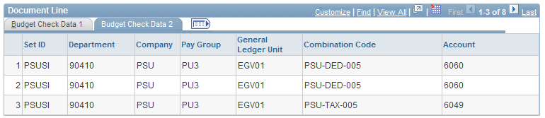

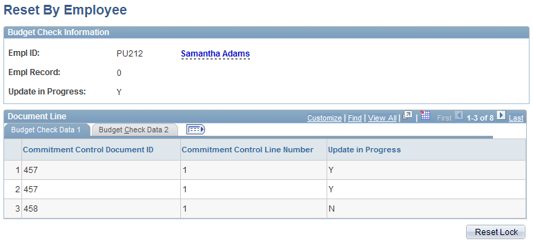

Use the Reset by Employee page (HP_RESET_LOCK_JOB) to review locks placed by real-time budget checking for job data changes, and reset the locks if necessary.
Navigation:
This example illustrates the fields and controls on the Reset By Employee page: Budget Check Data 1 tab.
This example illustrates the fields and controls on the Reset By Employee page: Budget Check Data 2 tab.

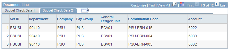

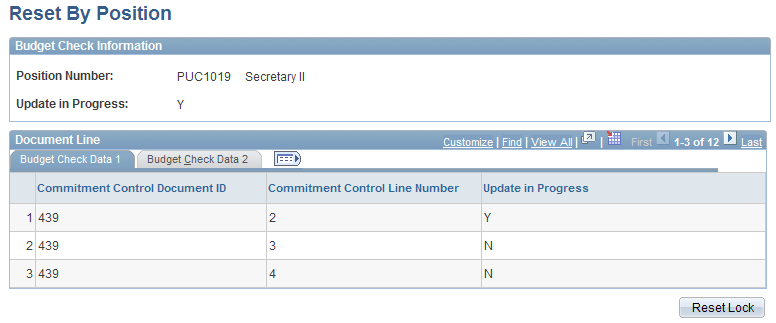

Use the Reset by Position page (HP_RESET_LOCK_POS) to review locks placed by real-time budget checking for position data changes, and reset the locks if necessary.
Navigation:
This example illustrates the fields and controls on the Reset By Position page: Budget Check Data 1 tab.
This example illustrates the fields and controls on the Reset By Position page: Budget Check Data 2 tab.

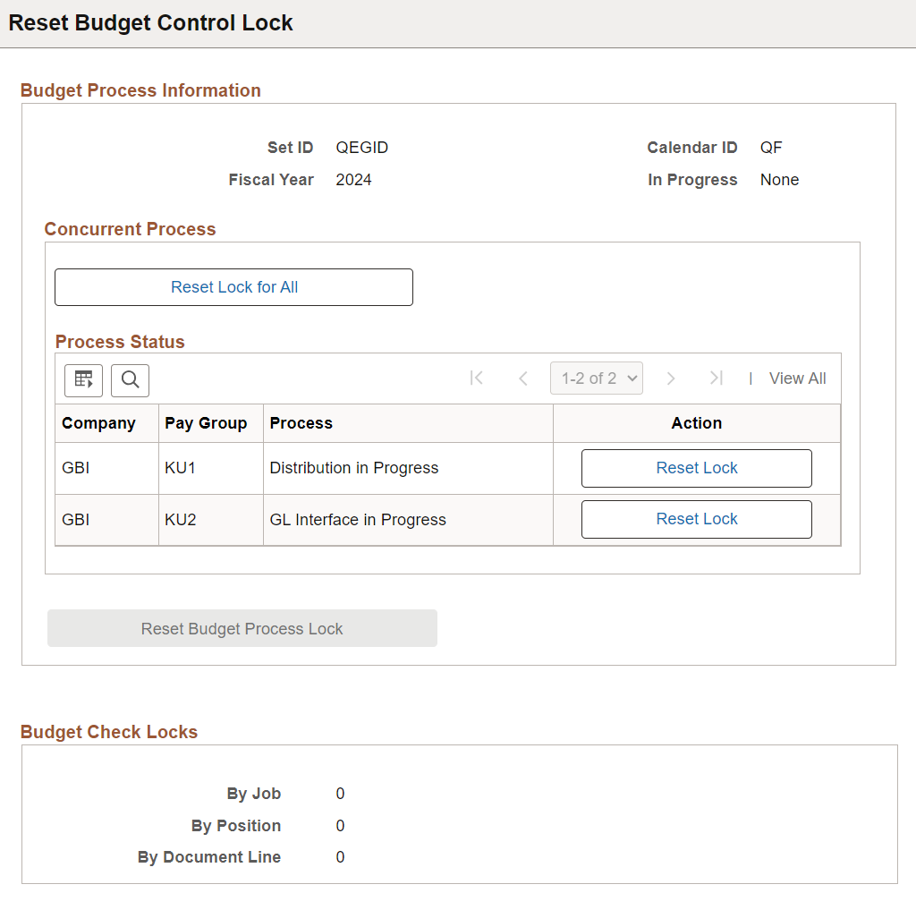

Use the Reset Budget Control Lock page (HP_RESET_LOCK_BCH) to review locks placed by running budget or liquidation processes, and reset the locks if necessary.
Navigation:
This example illustrates the fields and controls on the Reset Budget Control Lock page.
Field or Control |
Description |
In Progress |
Displays, if applicable, the budget process that is currently running, for example, Actuals Distribution, Encumbrance Calculation, Fiscal Year End Encumbrance Cleanup, and so on. If no process is currently running, or the lock of the current process is reset (by selecting the Reset Budget Process Lock button), None is displayed. |
Reset Budget Process Lock |
Select to remove the lock of the running process that is displayed on the In Progress field, and update that field value to None. This button becomes active when a running process appears in the In Progress field. |
Concurrent Process
The Concurrent Process section displays budget concurrent processes (with corresponding company and pay group) that are currently running in the system, if the Enable Concurrent Process option is enabled on the Payroll for NA Installation Page.
If the Enable Concurrent Process option is cleared, or if the option is selected but there are no concurrent processes running at the time, the No Concurrent process running message is displayed.
Field or Control |
Description |
Reset Lock for All |
Select to reset the locks of all company and pay group entries in the Process Status section and update the Process field values to None. |
Process |
Displays the budget process that is currently running for the associated company and pay group, if available. Values include: Distribution in Progress GL Interface in Progress None |
Reset Lock |
Select to remove the lock of the corresponding process and update the Process field value to None. |
Budget Check Locks
This section displays the number of locks that are currently placed by real-time budget checking, grouped by job, by position, and by document line.
