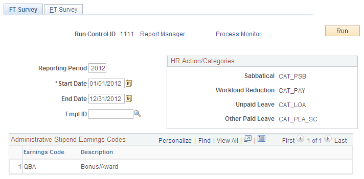

Use the FT Survey (full-time survey) page (RUNCTL_HPH901CN) to load FT survey data for each FT employee who qualifies.
Before using this page, complete the Member Data Table for all FT teaching members in the survey.
Navigation:
This example illustrates the fields and controls on the FT Survey page.
HR/Action Categories
Field or Control |
Description |
Sabbatical, Workload Reduction, Unpaid Leave and Other Paid Leave |
Displays the HR Action/Categories from the Reporting Period Stats CAN page. |
Earnings Code |
Displays the earnings code used to pay annual stipends, or other honoraria for administrative duties. |
