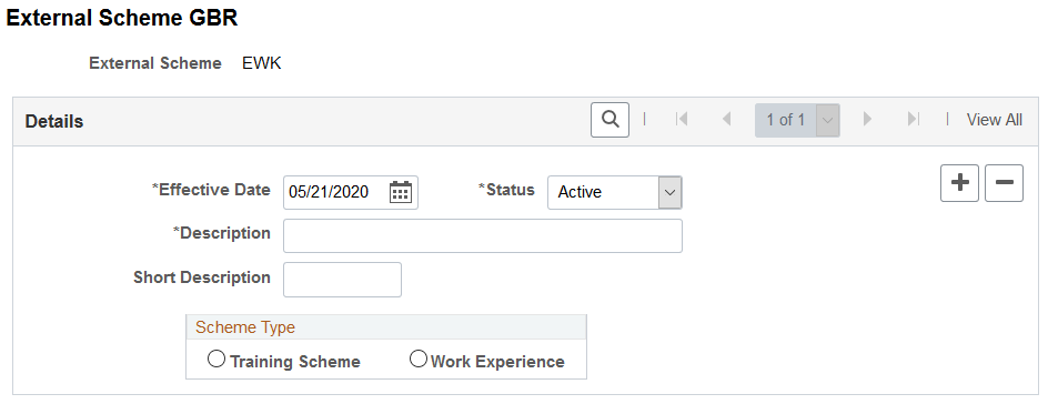

This example illustrates the fields and controls on the External Scheme GBR page. You can find definitions for the fields and controls later on this page.
Field or Control |
Description |
External Scheme |
The external scheme code that you entered appears in this field. Use this field on the Employment Details page. |
Scheme Type |
Select the appropriate option to indicate whether the scheme type is a Training Scheme or Work Experience. |
