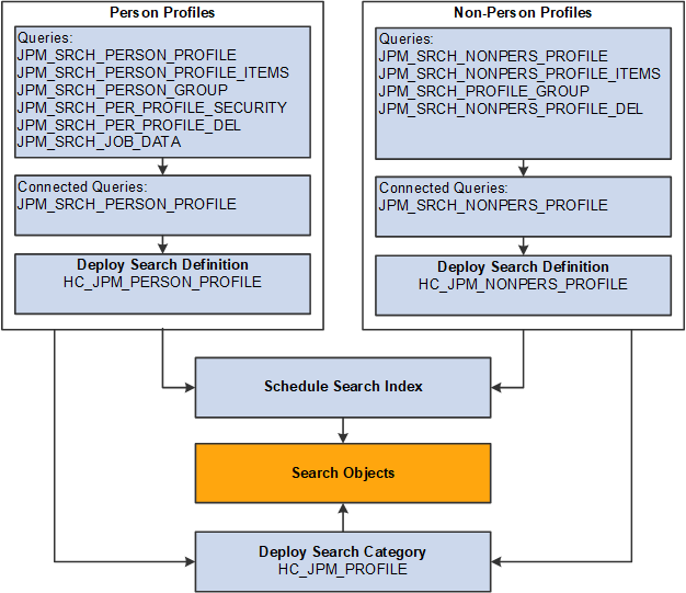

Deploy the profile Search Category that combines the non-person and person profile documents into a single searchable object.
Warning! This is required for the Search and Compare Profiles transaction. The Search and Compare Profile process requires that the Search Categories be used as delivered and should not be renamed.
The diagram illustrates how the queries, search definitions, search category, and search index schedule relate to each other:

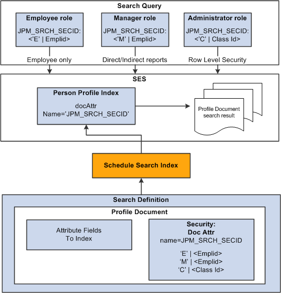

Document level security exists for Person Profiles. The administrator can only view profiles for employees in their range of HCM row-level security. Managers can only view profiles for direct and indirect reports. Employees can only view their own profile.
The list of “manager access” EmplIDs and “administrator access” Class Ids is merged into a single Document Security Attribute called JPM_SRCH_SECID. When a search is executed against the Person Profile Index, this security attribute is automatically filtered based on the Profile Management role that issues the query.
This diagram illustrates how document level security will add security attributes to the profile document and search framework will automatically apply a list of values to be matched against the security attributes of those documents returned by the search query.

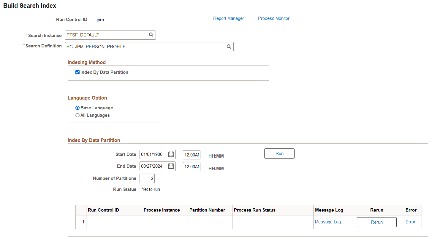

Use the Build Search Index page (PTSF_SCHEDULE_SI) to run the process that builds the search index for a person or non-person profile.
Navigation:
This example illustrates the fields and controls on the Build Search Index page. You can find definitions for the fields and controls later on this page.
This example illustrates the fields and controls on the Build Search Index page with Index By Data Partition selected.
Field or Control |
Description |
Search Definition |
Select HC_JPM_NONPERSON_PROFILE for non-person profiles, or HC_JPM_PERSON_PROFILE for person profiles. Note: These search definitions must be deployed prior to running this process. |
Index By Data Partition |
Select to run the index in partitioning mode. This also displays the Index By Data Partition group box. |
Language Option |
Select the Base Language option for the Non-person Profile index and when using classic Profile Management. (Fluid only) Select the All Languages option to build the Person Profile index if multiple languages are enabled for the PS environment |
Indexing type |
Select on of these values: Full index: Builds a new index for the selected search definition. Incremental Index: Updates the existing index for the selected search definition. |
Note: Profile Management supports data partitioning for the FULL index build only.
Field or Control |
Description |
Start Date and End Date |
Enter the required start and end date. The Start Date should always be ’01/01/1900’ and the End Date should be the current date. |
Number of Partitions |
Specify the Number of Partitions, then select the Run button. Note: Search indexes are delivered to handle a maximum of two partitions, but this can be changed if more partitions are desired. Person Profile (JPM_PP_TMP) and Non-Person Profile (JPM_NP_TMP) data partition AE’s are defined with a temporary table instance count to support this number of partitions. The instance count should be set to twice the number of parallel instances. As delivered, this assumes 2 parallel instances will be used so the instance count is 4 [(2 * 2) = 4]. See also PeopleTools: Search Technology Engine, "Administering PeopleSoft Search Framework," Working with Search Indexes and PeopleTools: Application Engine, "Creating Application Engine Programs," Setting Program Properties. |
