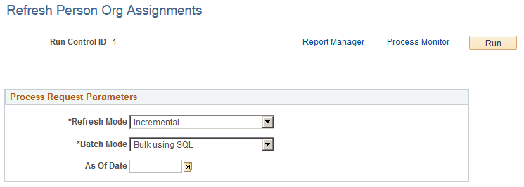

Use the Refresh Person Org Assignments page (PERORGASGN_REFRESH) to run the Refresh Person Org Assignments (HR_PERORGASN) batch process to update Business Title and Position Phone field values in Employment Data.
Navigation:
Set Up HCMSystem AdministrationDatabase ProcessesRefresh Person Org AssignmentsRefresh Person Org Assignments
This example illustrates the fields and controls on the Refresh Person Org Assignments page. You can find definitions for the fields and controls later on this page.
Video: Image Highlights, PeopleSoft HCM Update Image 19: Mass Updates for Business Titles
Business Title and Position Phone fields present in Employment Data get their values from the position corresponding to the current Job record, provided position data is not overridden. Use the Refresh Person Org Assignments application engine batch process to update the Employment Data record with the Business Title and Position Phone fields for future dated rows that have become current. This batch process also takes into consideration related language values. This batch process can be used as a refresh process to update data whenever required or as a nightly refresh.
Field or Control |
Description |
Refresh Mode |
Select the refresh mode to indicate what rows of data the process should update. Values include:
Batch Mode |
Select the batch mode to indicate how the process should perform the updates. Values include:
As Of Date |
Specify the date to determine the incremental changes done to Job Data and Position Data. Note: Leave this field blank when you schedule this run control ID to run on a recurring basis. The system will use the current system date each time it runs. This field is available when the Incremental option is selected for the Refresh Mode value. |
This process will update the Business Title and Position Phone field values in Employment Data for active current Job records and Job records which have a future dated row with HIR, REH, ADD, and POI actions.
This process will also update existing related language entries with new values, delete existing entries that have become invalid, and insert new related language entries that are not present.
