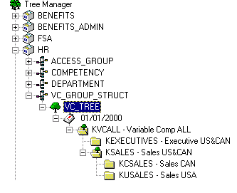

Sample Group Tree
This example illustrates a tree named VC_Tree and includes various groups and subgroups.
This is a VC Tree example showing the relationships of various groups and subgroups.

Identifying Managers and Approvers
Because the approvers in this example are the higher-level managers, they are not members of the groups they approve.
Managers generally are members of the groups they manage. In this example, the group KUSALES is an exception because it is managed by KC0008, who manages KCSALES. KC0008 is a member of KCSALES but not of KUSALES.
In this example, the user ID is identical to the employee ID.
