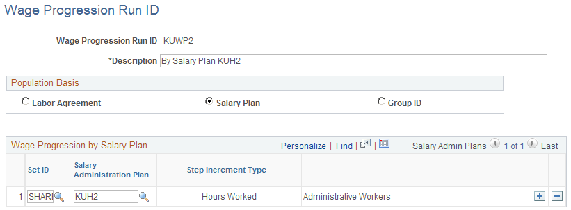

Use the Wage Progression Run ID page (HR_WP_ID_DEFN) to define groups of workers to manage throughout the wage progression process.
Navigation:
This example illustrates the Wage Progression Run ID page.
Wage Progression Population Basis
Choose the method by which to determine the population for the wage progression run ID:
Labor Agreement
Salary Plan
Group ID
Wage Progression by Bargaining Unit
When you select Labor Agreement as your run ID population basis, enter one or more labor agreements in the grid and the workers associated with the selected labor agreements will make up the run ID population.
Wage Progression by Salary Plan
When you select Salary Plan as your run ID population basis, enter one or more salary plans in the grid and the workers associated with the selected plans will make up the run ID population.
Wage Progression by Group ID
When you select Group ID as your run ID population basis, enter one group ID and the workers associated with the selected group ID will make up the run ID population.
