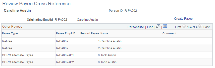

Use the Review Payee Cross Reference page (PA_RT_EMP_XREF) to view a list of all the payee records associated with a particular employee.

This example illustrates the fields and controls on the Review Payee Cross Reference page.

Originating Emplid (originating employee identification) |
If the employee is a beneficiary or QDRO alternate payee, this field contains the id and name of the employee who originally earned the pension that the non-employee will collect. If the employee is a retiree or is terminated deferred-vested, the originating employee is the same person as the retiree. |
Other Payees
This section displays all the retiree job records for the employee. It also shows any beneficiaries or QDRO alternate payees who are entitled to a portion of the employee's benefit.

Payee Type |
For each payee listed, the payee type displays Retiree, Terminated Deferred Vested, Beneficiary, or QDRO Alternate Payee. |
Payee Empl ID |
For retirees and terminated deferred-vested employees, the payee ID is the same as the employee ID. |
Record Payee (payee record number) |
The payee record number is the job number, a sequential number that identifies each job you create. So, for example, if you create three retiree jobs for an employee, because the employee is collecting pension benefits from three plans, you see the three different job numbers here. For a retiree or terminated deferred-vested employee, an active employment record represents a "real" job, not a retiree job. A record number for a beneficiary or QDRO alternate payee represents a payee record. |
Name |
This field displays the name of the payee. |
