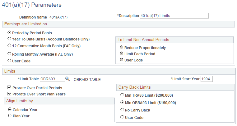

Use the 401(a)(17) Parameters page (PA_401A17_PARMS) to set up 401(a)(17) parameters.
Navigation:
This example illustrates the fields and controls on the 401(a)(17) Parameters page.
The 401(a)(17) limits are published annually by the IRS. Because the limits can change over time, it is important to identify the correct limit for each earnings period.
Earnings are Limited on
Besides identifying the limit for each earnings period, you need to specify a method for applying the limit:

Limits
401(a)(17) limits came into effect in 1989. Calculations with an event date prior to 1989 do not use 401(a)(17) limits. If you align by plan year, event dates in the 1988–1989 plan year are also considered exempt from 401(a)(17) limits. If the event date is 1989 or later, however, you can limit all of an employee's earnings, not just earnings after 1989.
Field or Control |
Description |
Limit Table |
The system looks up the limit for each year using the table lookup utility. The table used associates calendar years with limits. The system comes with two predefined table lookups for the most common limit tables:
You can examine both of these tables under 401(a)(17) Limits. To see the table lookup parameters, go to Table Lookup Alias. If you look at either of the delivered table lookups, you can see that they are "program generated." This means that 401(a)(17) processing provides the lookup year for each period. If you decide to develop your own limit table, perhaps one that blends TRA and OBRA limits, be sure to make it a program generated lookup. You can also see that the delivered lookups are set to use the maximum (that is, the latest) value when the lookup year is after the last year in the table. This means that the limit is not projected (projected earnings use the last available limits). |
Prorate Over Partial Periods |
Select this to prorate the limits for short periods, including the final period, when you limit on a period by period basis. During partial periods, employees frequently have lower earnings and therefore are less likely to reach the 401(a)(17) limit. For example, an employee with 100,000 USD of earnings in a six-month partial period is under the 150,000 USD limit. If you prorate the limit, the half-year limit is 75,000 USD, and the employee has exceeded that amount. This option is irrelevant for the other limit methods. When you limit on a 12 consecutive month basis, partial periods are irrelevant because the system goes back to previous periods to form only complete periods. You also do not prorate when you limit on a year-to-date basis: The premise of applying the limits on a year to date basis is that your earnings count until you reach the limit, regardless of when during the year you reach that limit. |
Prorate Over Short Plan Years |
If you align limits by plan year, a change in plan year results in a partial period. You therefore also have the option to prorate over short plan years. This option only applies when you apply the limits on a year-to-date basis using monthly consolidations. In order for the system to recognize short plan years, the short year must have its own effective-dated row in the Pension Plans (US) table. |
Limit Start Year |
Because there are no published limits for years prior to 1989, you must choose what limit, if any, to use for those earlier years. The amount you use is the "carry back" limit. It is applied to all years from the hire date until the limit start year. Beginning with the limit start year, the limits are determined based on the table lookup that you specified in the Limit Table field. Enter a limit start year, then select a carry back option. |

Align Limits by
Regardless of the period being limited (month, calendar year, plan year, or other year), the system determines the limit based on your Align Limits by choice. This setting also determines the limit for the event date, which is used as a final limit for the final average earnings result.
