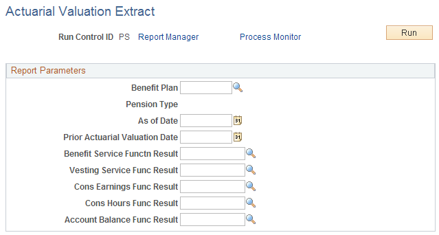

Use the Actuarial Valuation Extract page (RUNCTL_PASAV01) to generate the actuarial valuation extract files that are used to perform a plan's annual actuarial valuation.
Navigation:
This example illustrates the fields and controls on the Actuarial Valuation Extract page.
Because the actuarial valuation extract uses pension status codes, do not run the extract until you finish the periodic processing and payment processes for the year you are processing. These two processes change status codes, and you want to be sure all the status codes are current before you run the extract.
Report Parameters
To run the extract, enter the following parameters:
Field or Control |
Description |
Benefit Plan |
Select the plan for which you are running the extract. |
As Of Date |
Enter the date to establish the current year valuation category. |
Prior Actuarial Valuation Date |
Enter the date to establish the prior year valuation category. The current year and prior year dates are used to determine the extract files in which an employee is included: the active extract, inactive extract, or both. |
Benefit Service Functn Result, Vesting Service Func Result, Cons Earnings Func Result, Cons Hours Fun Result, and Account Balance Func Result (benefit service function result, vesting service function result, cons earnings function result, cons hours function result, account balance function result) |
Use these fields to direct the extract to the correct source of plan information that the actuary needs to see for each employee. Note: Account balances apply only to cash balance accounts. |
