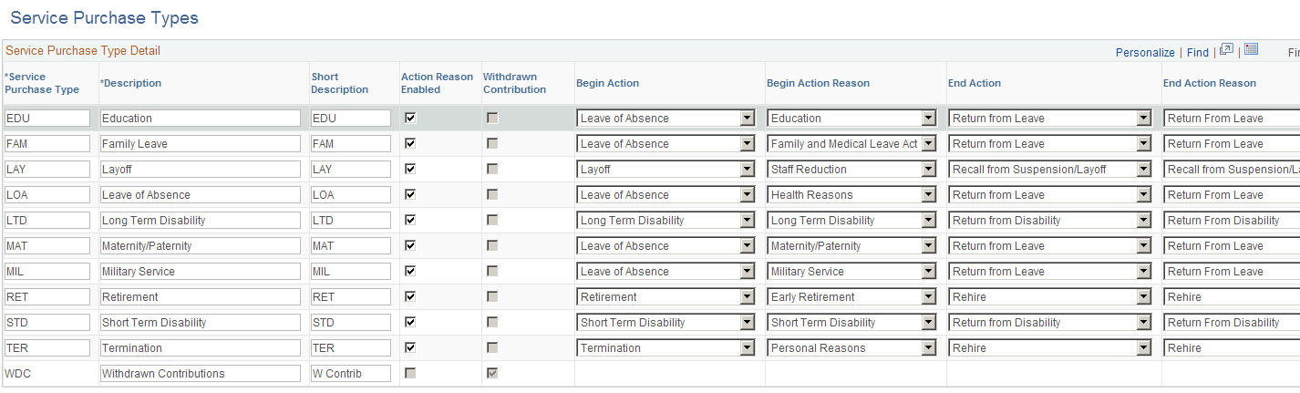

Use the Service Purchase Types page (PA_SP_TYPE_DEFN) to set up service purchase types.
Navigation:
This example illustrates the Service Purchase Type page.

Action Reason Enabled |
Select this check box if the service purchase type is for a period when the employee was not working, such as a leave of absence. If you select this check box, you must also enter values in the Begin Action and End Action fields. |
Withdrawn Contribution |
Select this check box if the service purchase type is for reinstating service that was forfeited when the employee withdrew contributions. When this check box is selected, the Action Reason Enabled check box is not available, and all of the action and action reason fields are hidden for this service purchase type. Oracle delivers a service purchase type, WDC, for withdrawn contributions, so it is not necessary for you to create one. |
Begin Action |
For a service purchase type that is action enabled, select the action that represents the start of the service period. |
Begin Action Reason |
If the start of the service period is associated with an action reason in addition to an action, select the reason that represents the start of the service period. |
End Action |
For a service purchase type that is action enabled, select the action that represents the end of the service period. |
End Action Reason |
If the end of the service period is associated with an action reason in addition to an action, select the reason that represents the end of the service period. |
