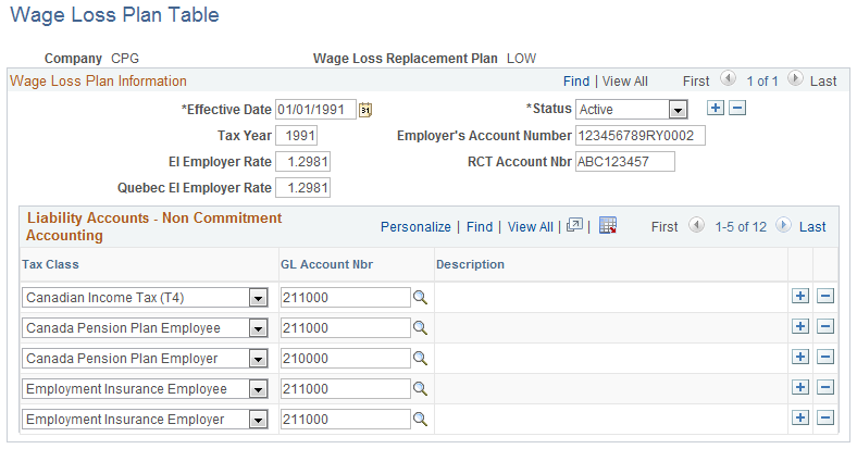

Use the Wage Loss Plan Table page (WAGELS_PLN_TBL1) to define a wage loss plan for your company.

This example illustrates the fields and controls on the Wage Loss Plan Table page.
Wage Loss Plan Information
Field or Control |
Description |
Employer’s Account Number |
For each plan you set up, enter your company's unique CRA Taxation account number in this field. Because a company can have more than one wage loss replacement plan, you can set up any number of plans on this table. |
EI Employer Rate |
This is the rate of your contribution to Employment Insurance. The default rate (which comes from the Employer EI Premium Rate on the Canadian Tax table) may be overridden with your specific plan rate. |
RCT Account Number |
This field is hidden on the page for all entries with an Effective Date of 01/01/1997 or later. The field will be displayed and is available for use for all entries dated prior to 01/01/1997 for historical purposes only. |
Quebec EI Employer Rate |
This is the rate of your contribution to Employment Insurance. You can override the default rate (which comes from the Quebec Employer EI Premium Rate on the Canadian Tax table) by entering your specific plan rate. |
