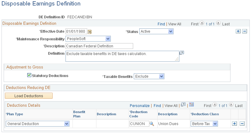

Use the Disposable Earnings Definition page (GARNISH_DE_DEFN) to review and update disposable earnings definitions.
Navigation:
This example illustrates the fields and controls on the Disposable Earnings Definition page.
Field or Control |
Description |
DE Definition ID (disposable earnings definition ID) |
This ID links the garnishment disposable earnings definition to the applicable Garnishment Rules table. |
(CAN) Adjustment to Gross
The fields in this group box appear on the page for Canadian users only. They are for information only.
Deductions Reducing DE
Some court orders require that you subtract deductions from the employee's gross pay to arrive at disposable earnings. Use this group box to enter deductions to use when calculating disposable earnings.
Note: During the implementation process, enter the deductions to reduce the disposable earnings subject to garnishment.
Field or Control |
Description |
Load Deductions |
Select to access the Load Deductions to Reduce DE page, where you can load deductions into the Deductions Details grid by plan type, or by plan type and benefit plan. Note: You cannot use this option to load general deductions. You must enter general deductions into the Deduction Details grid manually. |
Deductions Details |
You can manually enter deductions using the editable fields in this grid. General deductions must be manually entered. If you load deductions using the Load Deductions option, the system replaces the existing deductions having the same selection criteria. After loading deductions using the Load Deductions button, you can delete any of the loaded deductions that are not appropriate. You can also add additional deductions manually or by using the Load Deductions option again. Note: After loading and editing the deductions, you must save the page. |

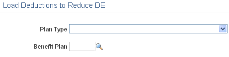

Use the Load Deductions to Reduce DE (load deductions to reduce earnings definition) page (GARN_DE_SEC) to load deductions into the Disposable Earnings Definition page by plan type, or by plan type and benefit plan.
Navigation:
Select Load Deductions on the Disposable Earnings Definition page.
This example illustrates the fields and controls on the Load Deductions to Reduce DE (earnings definition) page.
To load deductions:
Select a plan type or combination of plan type and benefit plan.
The system selects all deductions in the plan type or benefit plan that:
Are active as of the effective date of the DE definition.
Have deduction classification After Tax or Before Tax.
Select OK to load deductions that meet the criteria into the Garnishments DE Deduction table (GARN_DE_DED) and into the grid on the Disposable Earnings Definition page, where you can further edit the list.
Select the Load Deductions option on the Disposable Earnings Definition page to return to this page to select and load deductions from additional plan types or benefit plans.
