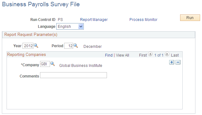

(CAN) Use the Business Payrolls Survey File page (RUNCTL_PAY104CN) to create a BPS EDR file for transmission to Statistics Canada and a summary report for your reference.
The system produces the transmission file in accordance with the format provided by Statistics Canada.
Navigation:
This example illustrates the fields and controls on the Business Payrolls Survey File page.
Field or Control |
Description |
Year and Period |
Select the year and a month from 1–12. This is the reference month that the system uses to select payroll data for reporting. |
Company |
Each company selected corresponds to a Business and Contact Information record (Record Type 1) in the EDR file. |
