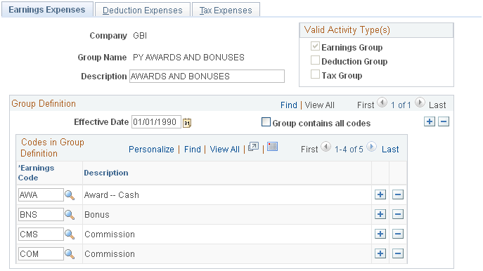

Use the Earnings Expenses page (PYGL_ACTIVE_ERNGRP) to group earnings codes into expense groups.
Navigation:
This example illustrates the fields and controls on the Earnings Expenses page.
Field or Control |
Description |
Valid Activity Type(s) |
Select Earnings Group. |
Group contains all codes |
To create the required default earnings group, select Group contains all codes. This group is used for any earnings expenses that are not included in a specific group. When you select this check box, the other fields on the page disappear. |
Codes in Group Definition
Field or Control |
Description |
Earnings Code |
Select earnings codes to include in this group. |

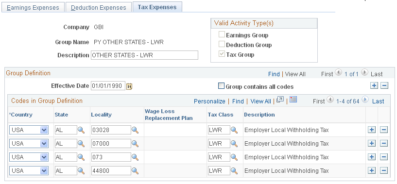

Use the Tax Expenses page (PYGL_ACTIVE_TAXGRP) to group taxes into expense groups.
Navigation:
This example illustrates the fields and controls on the Tax Expenses page.
Field or Control |
Description |
Select Tax Group. |
To create the required default tax group, select Group contains all codes. This group is used for any tax expenses that are not included in a specific group. When you select this check box, the other fields on the page disappear. |
Field or Control |
Description |
Country |
The country that you select determines the fields that are available for data entry: USA: The State, Locality, and Tax Class fields are available. Canada: The Wage Loss Replacement Plan and Tax Class fields are available. |
State and Locality |
(USA) Use of the State and Locality fields depends upon the type of tax and the location. For example, FICA OASDI is a federal tax that would not require the State and Locality fields. |
Wage Loss Replacement Plan |
(CAN) Set up a separate group for each different wage loss plan for purposes of employment insurance (EI). |
Tax Class |
Tax Class is always a required field. The values available for selection depend upon the values selected in preceding fields. |
