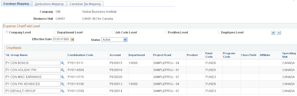

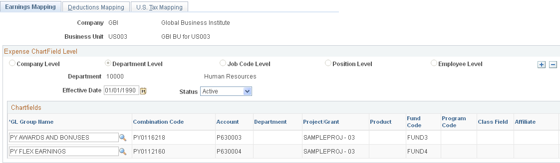

Use the Earnings Mapping page (PYGL_CO_CF_MAPERN) to specify mapping level and map earnings expense groups to ChartField combinations.
Navigation:
This example illustrates the fields and controls on the Earnings Mapping page.
Note: The whole page is not shown here. The fields displayed on the page are determined by the ChartField configuration.

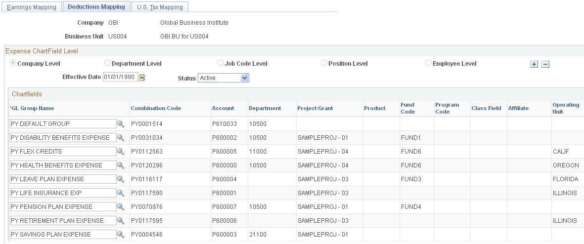

Use the Deductions Mapping page (PYGL_CO_CF_MAPDED) to specify mapping level and map deduction expense groups to ChartField combinations.
Navigation:
This example illustrates the fields and controls on the Deductions Mapping page.

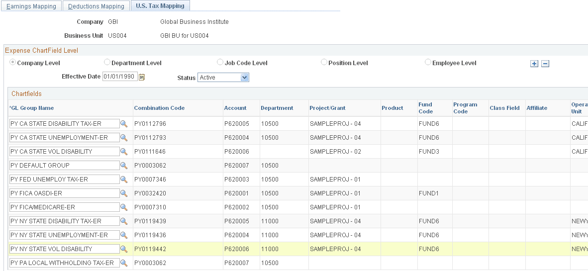

(USA) Use the U.S. Tax Mapping page (PYGL_CO_CF_MAPTAX) to specify mapping level and map U.S. tax expense groups to ChartField combinations.
Navigation:
This example illustrates the fields and controls on the U.S. Tax Mapping page.
