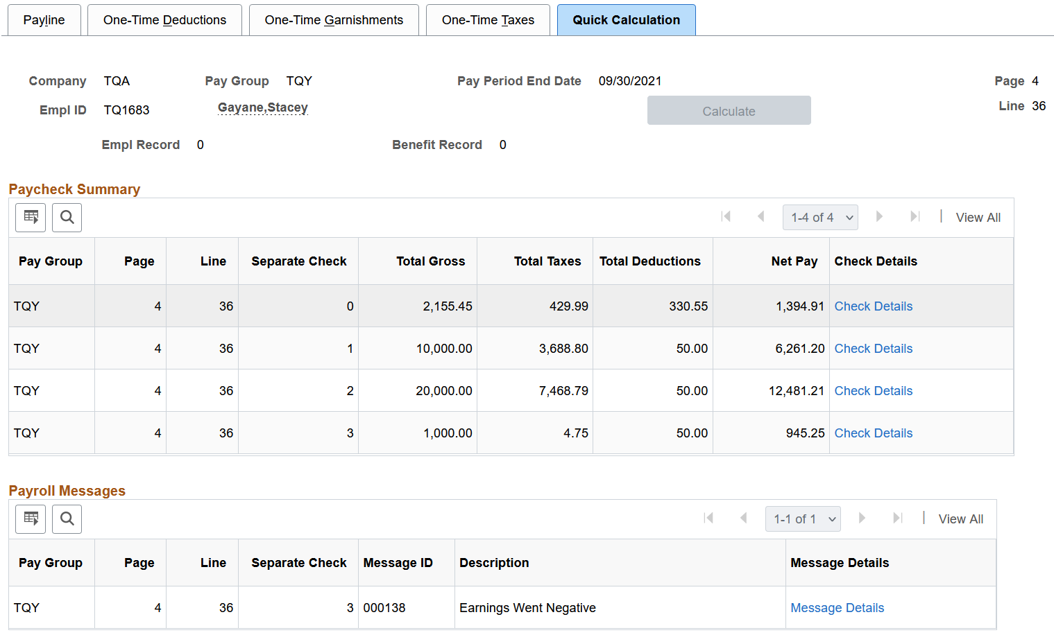

Use the Quick Calculation page (PAY_SHEET_LINE_Q) to generate and review calculated checks for individual employees.
Navigation:
This example illustrates the fields and controls on the Quick Calculation page after the check has been calculated.
When you select the Calculate button, payroll calculation runs in the background for a single employee. Paycheck results are displayed at the end of the calculation.

Paycheck Summary
This section displays the summary and details of the calculated paychecks. It appears after the quick calculation is completed.
Paycheck information is no longer available in this section if the payline that was used to calculate the paycheck has been modified.
Field or Control |
Description |
Check Details |
Select to view the detailed paycheck data for the employee on the Review Paycheck pages that appear. See Also Paycheck Earnings Page, Paycheck Taxes Page, and Paycheck Deductions Page. |
Payroll Messages
This section displays error messages generated during the payroll processing. Select the Message Details link to view the details on the Review Payroll Error Messages Page.

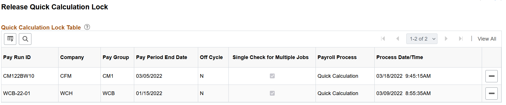

Use the Release Quick Calculation Lock page (PY_QCALC_LOCK_TBL) to delete unsuccessful payroll processes from the lock table.
Navigation:
This example illustrates the fields and controls on the Release Quick Calculation Lock page.
Field or Control |
Description |
Pay Run ID |
Displays the pay run ID that is associated with the company and paygroup of the employee being processed. |
Company, Pay Group, Pay Period End Date, and Off Cycle |
Displays the corresponding values that are associated with the employee. |
Single Check for Multiple Jobs |
Displays as selected, if the field of the same name is selected on the Default Settings Page for a company that is associated with the pay run ID. |
Payroll Process |
Displays the payroll process that was launched, Payroll Calculation or Quick Calculation. |
Select the Delete button to release the lock for all companies and paygroups that are associated with the specified pay run ID. |
