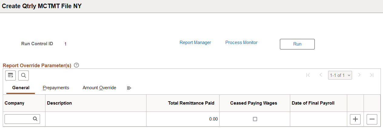

Use the Create Qtrly MCTMT File NY page (RUNCTL_TAX820NY) to generate electronic files and print quarterly New York Metropolitan Commuter Transportation Mobility Tax (MCTMT) reports.
Navigation:
Payroll for North America > U.S. Quarterly Processing > Quarterly Reports > Other Quarterly Reporting > Create Qtrly MCTMT File NY > Create Qtrly MCTMT File NY
This example illustrates the fields and controls on the Create Qtrly MCTMT File NY page.
Important! To create quarterly MCTMT reports, you need to launch the TAX820NY program twice.
First, run the program without any specified parameters. The purpose of this run is to prepare values to be displayed in the Total Remittance Paid field for Zone 1 and Zone 2 on the General tab.
After running the program for the first time, you can specify companies in the Report Override Parameter(s) section and make updates as needed. When a company is selected, the system displays the total amount that it is remitting with this filing in the Total Remittance Paid field. Run the program again to generate quarterly MCTMT reports.
