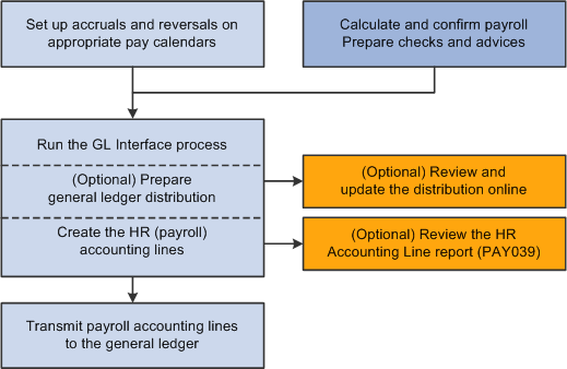

Processing Steps
This diagram illustrates the general ledger processing steps to transmit payroll accounting lines to the general ledger:
After the GL interface setup is complete, these are the ongoing steps for each payroll cycle:
Verify that the payroll is confirmed.
Run the GL Interface process.
You can run the GL Interface Application Engine process (PAYGL01) in one step or two separate steps:
(Optional) Prepare the distribution without generating the HR accounting lines, then review and update the distribution in online pages.
(Required) Generate the HR accounting lines.
Publish the contents of the HR Accounting Line table to PeopleSoft General Ledger.
Note: Payroll for North America does not subscribe to any post-processing messages that are published by PeopleSoft General Ledger.

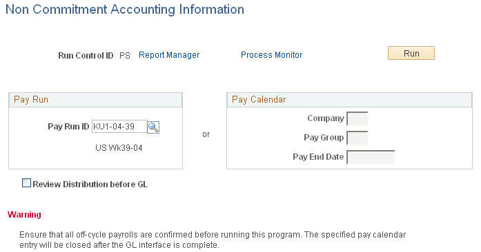

Use the Non Commitment Accounting Information page (RUNCTL_PAYGL01) to run the PAYGL01.
SQR process and produce output in the form of accounting lines to be recognized by PeopleSoft Journal Generator.
Navigation:
This example illustrates the fields and controls on the Non Commitment Accounting Information page.
To run the process:
Enter the pay run ID that you want to process. Alternatively, if you have more than one pay calendar for a pay run ID and want to process an individual pay calendar, enter the company, pay group, and pay end date for that pay calendar. The system processes both on-cycle and off-cycle information.
Select the Run button to display the Process Scheduler page.
Select the GL Interface (general ledger interface) check box and select the OK button to complete the process.
(E&G) If you want to interface E&G 7.5 to PeopleSoft General Ledger 8, then select the GL Interface - EG 7.5 (general ledger interface - education and government 7.5) check box.
Field or Control  |
Description  |
Review Distribution before GL  |
 Select the Review distribution before GL (review distribution before general ledger) check box to review the data before creating the lines for General Ledger. This check box is deselected by default. If you want to stop and review the distribution before creating the accounting lines, you must select this check box. If you don't select it, the process automatically creates the accounting lines.  |

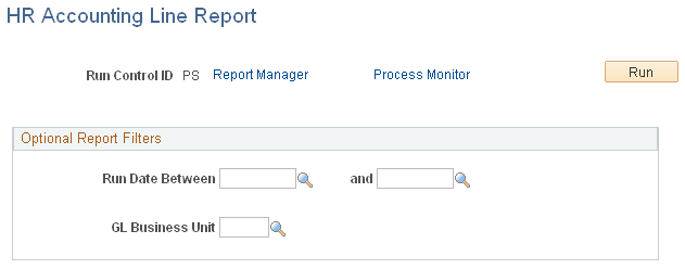

Use the HR Accounting Line Report page (RUN_PAY039) to generate the PAY039 report that lists the accounting line entries created by running the GL Interface process (PAYGL01).
Navigation:
This example illustrates the fields and controls on the HR Accounting Line Report page.
Optional Report Filters
You can limit the report results for a specified date range and GL business unit.
Field or Control  |
Description  |
Run Date Between and GL Business Unit  |
 You can run the report with these fields blank. If you specify a beginning date but no ending date, the system enters the beginning date as the default ending date value.  |

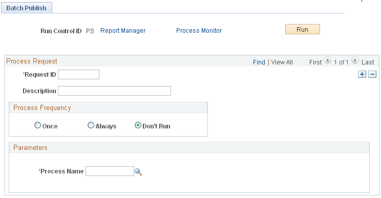

Use the Batch Publish page (EO_BATCHPUB) to after running the PAYGL01 process on the PeopleSoft HCM database to create the Accounting Line table, run the Manual Batch Publish Application Engine process (EOP_PUBLISHM) to transfer Payroll for North America data to PeopleSoft General Ledger.
Navigation:
This example illustrates the fields and controls on the Batch Publish page.
Field or Control  |
Description  |
Process Frequency  |
 Typically, you select Always.  |
Process Name  |
 Select PAYGL01.  |
Note: Before trying to send any transactions to PeopleSoft General Ledger, verify with your IT staff that PeopleSoft Integration Broker nodes, queues, and service operations (routings and handlers) on have been activated .
