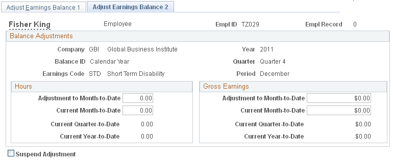

(USA, USF) Use the Adjust Earnings Balance 2 page (ADJ_ERN_BAL2) to change earnings balances.
(CAN) Use the Adjust Earnings Balance 2 page (ADJ_CN_ERN_BAL2) to change earnings balances.
Note: The (CAN) Adjust Earnings Balance 2 page is, except for the object name, is the same as the (USA) Adjust Earnings Balance 2 page.
Navigation:
This example illustrates the fields and controls on the Adjust Earnings Balance 2 page.
Note: To access this page you must first enter identifying criteria on the Adjust Earnings Balance 1 page and save it.
Field or Control |
Description |
Adjustment Month-to-Date and Current Month-to-Date |
If you enter a new current month-to-date balance, the system calculates the adjustment to month-to-date; if you enter an adjustment to month-to-date, the system calculates the new current month-to-date. |
