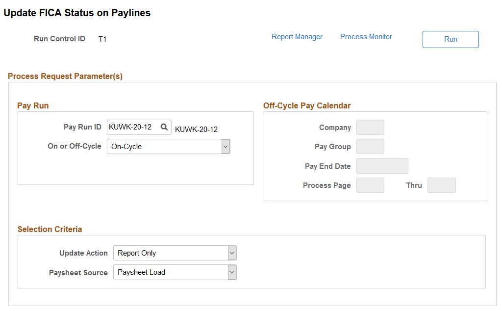

Use the Update FICA Status on Paylines page (PY_UPD_FICA_ST) to print Update FICA Status on Paylines reports.
Navigation:
This example illustrates the fields and controls on the Update FICA Status on Paylines page.
Enter the run ID for an on-cycle or off-cycle pay calendar, or enter off-cycle pay calendar parameters to run the Update FICA Status process.

Update Action |
Select the mode of the report. Values are: Report Only: Select this option after running the Load Paysheets or Load Time and Labor process for on-cycle and off-cycle payrolls. Update: Select this option after you review the report and are ready to make the updates, which include FICA status changes and moving earnings codes to new additional lines. |

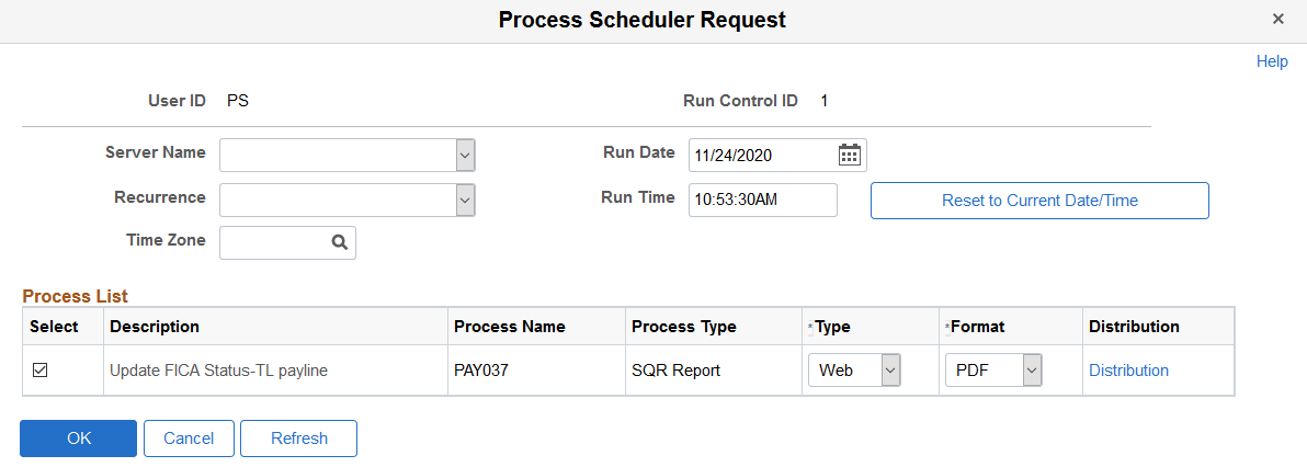

This example shows the preselection of the PAY037 report on the Process Scheduler Request page when Time and Labor Load is selected as the paysheet source on the Update FICA Status on Paylines run control page.
This example shows the preselection of the PAY037B report on the Process Scheduler Request page when Paysheet Load is selected as the paysheet source on the Update FICA Status on Paylines run control page.
