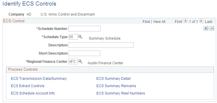

(USF) Use the Identify ECS Controls (identify electronic certification system controls) page (GVT_ECS_CONTRO_TBL) to establish ECS control information for payroll schedules.
Navigation:
This example illustrates the fields and controls on the Identify ECS Controls page.
Important! PeopleSoft ECS interface process has been replaced by the Treasury Interface functionality.
Field or Control  |
Description  |
Schedule Number  |
 This field accepts up to 14 characters, but the ECS accepts only the first 10. If you enter more than 10, you receive a warning message.  |
Schedule Type  |
 Determines the type of off-cycle distribution of deductions and net salary payments. Select:
Regional Finance Center  |
 Select the U.S. Financial Management Service (FMS) Regional Finance Center that's appropriate for your company.  |
Off-Cycle?  |
 You must select this check box for schedule types 03 and 07.  |
Process Controls
The links in this group box activate a series of pages where you define ECS process controls. The options that are available to you depend on the schedule type.

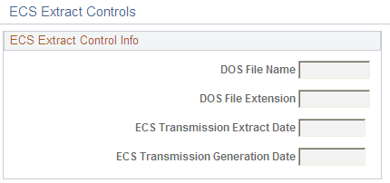

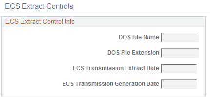

(USF) Use the ECS Extract Controls (electronic certification system extract controls) page (GVT_ECS_CNTL_SEC) to extract control information for the ECS transmittal.
Navigation:
Select the ECS Extract Controls (electronic certification system extract controls) link on the Identify ECS Controls page.
This example illustrates the fields and controls on the ECS Extract Controls page.
Field or Control  |
Description  |
DOS File Name and DOS File Extension  |
 For summary schedules, the Treasury interface updates the DOS file name and extension of the extract file to be transmitted to the treasury. The file name and extension are required on the Electronic Certification System Interface run control.  |
ECS Transmission Extract Dt (electronic certification system transmission extract date)  |
 Date on which the ECS interface generated the ECS file.  |
ECS Transmission Generation Dt (electronic certification system transmission generation date)  |
 Date on which the ECS schedule had all of the required information. This depends on the schedule type.  |

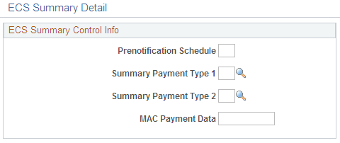

(USF) Use the ECS Summary Detail (electronic certification system summary detail) page (GVT_ECS_SUMM_SEC) to define the schedule and formats for the Treasury interface for summary payments such as check, electronic file transmission (EFT), VENMIS (vendor/miscellaneous), or bonds.
Navigation:
Select the ECS Summary Detail (electronic certification system summary detail) link on the Identify ECS Controls page.
This example illustrates the fields and controls on the ECS Summary Detail page.
Field or Control  |
Description  |
Prenotification Schedule?  |
 Not currently used.  |
Summary Payment Type 1  |
 Select the type of payments: Salary or Vendor (VENMIS).  |
Summary Payment Type 2  |
 Select the method of payment: Check or EFT (electronic file transmission).  |
MAC Payment Data (MAC payment data)  |
 Optional, for your information only.  |
