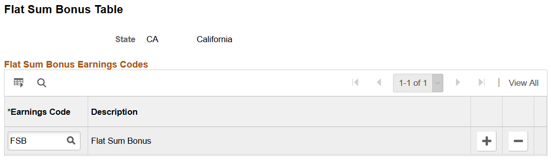

Use the Flat Sum Bonus Table page (FLAT_SUM_BONUS_TBL) to specify bonus earnings codes that are eligible for the Overtime on Flat Sum Bonus calculation in a specific state.
Navigation:
This example illustrates the fields and controls on the Flat Sum Bonus Table page.
Field or Control |
Description |
Earnings Code |
Enter an earnings code that is created for flat sum bonus payments. |
Note: Earnings codes that are added to this page are excluded from FLSA calculations in corresponding states.
Note: An earnings code (created for flat sum bonus) can be used by any US state. If the earnings code is not added to the Flat Sum Bonus Table page for a state, the calculation of overtime on flat sum bonus earnings code payments will remain the same as the standard FLSA overtime calculation for that state.
Currently, California is the only state for which a Flat Sum Bonus Table entry is required.
