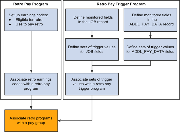

Retro Program Setup
To set up retro processing, you must define these two types of retro programs for each pay group:
Retro pay programs define the earnings codes on which retro pay can be calculated as well as the earnings codes used to pay the retro pay earnings.
Retro pay trigger programs control which record and field changes create retro requests.
To set up a retro pay trigger program:
Identify fields on the job record (JOB) and on the additional pay data record (ADDL_PAY_DATA) that trigger retro requests when changed.
Perform this task on the Retro Pay Monitored Fields page. The fields that you list on this page are the only fields that are available for retro triggers.
Note: If the delivered data for this page meets your needs, you can skip this step.
Define retro triggers—the specific field changes that trigger retro requests.
Perform this task on the Retro Pay Trigger Values page, where you assign Retro Pay Trigger Value IDs that you can use to reference the different sets of retro triggers.
On this page, list all of the retro trigger conditions for the record (though you configure the JOB and ADDL_PAY_DATA records separately).
Define a retro pay trigger program and identify its Retro Pay Trigger Value IDs.
Retro pay programs include up to two Retro Pay Trigger Value IDs: one for the job record, and one for the addition pay data record.
The following diagram illustrates the steps for defining retro programs and associating them with pay groups:
This example illustrates the fields and controls on the Steps for setting up retro programs.

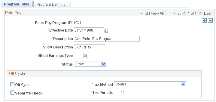

Use the Program Table page (RETROPAY_PGM_TBL) to describe a retro pay program and specify paysheet processing options.
Navigation:
This example illustrates the fields and controls on the Program Table page.
Field or Control |
Description |
Retro Pay Program ID |
This ID identifies the retro pay program when you associate the program with a pay group. |
Offset Earnings Type |
Select an offset earnings type for any negative earnings that are generated by the retro pay calculation. To avoid negative checks, link this earnings code to a payback deduction code. The system deducts the amount from subsequent paychecks of applicable employees. |
Off Cycle
Field or Control |
Description |
Off Cycle |
Select to create retroactive pay that is associated with this program as off-cycle earnings. If you deselect this check box, the system creates retroactive pay that is associated with this program as on-cycle earnings. After the system calculates retro pay, but before you load the retro pay to paysheets, you can change this setting on the Retro Pay Calculation Results page under Retroactive Payroll. |
Separate Check |
Select to load the earnings that are associated with this program to a separate check on the paysheets. |
Tax Method |
Select a tax method to load to the paysheet line for the earnings in this program. |
Tax Periods |
Enter the number of tax periods to load to the paysheet line for the earnings in this program. |

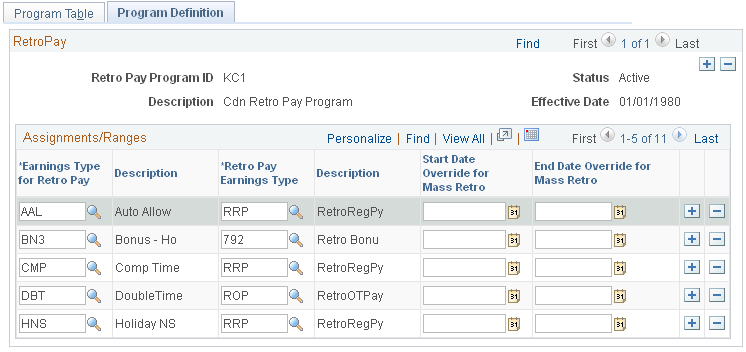

Use the Program Definition page (RETROPAY_PGM_DEF) to establish the earnings codes for which the retro pay program calculates retro pay and those used for paying retro pay earnings.
Navigation:
This example illustrates the fields and controls on the Program Definition page.
Assignments/Ranges
Create a row of data for each earnings code that is eligible for retro pay.
Field or Control |
Description |
Earnings Type for Retro Pay |
Select the earnings code that is eligible for retro pay. |
Retro Pay Earnings Type |
Enter the earnings code to use for the retro payment. |

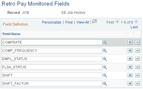

Use the Retro Pay Monitored Fields page (PY_RETROTBL_DEF) to list the job and additional pay fields that are available to use when you define the triggers that create retro requests.
Navigation:
This example illustrates the fields and controls on the Retro Pay Monitored Fields page.
Field or Control |
Description |
Record |
Oracle delivers definitions for the JOB record and the ADDL_PAY_DATA record. These are the only supported records for retro pay triggers. |
Field Name |
The fields in the Field Definition grid are the only fields that are available for use in retro triggers. Oracle delivers field lists for both the JOB and ADDL_PAY_DATA records. You can add and delete entries to change which fields are monitored. You cannot delete entries for fields that are used in current retro pay trigger value definitions. |
Delivered JOB Fields
The delivered configuration for the JOB record includes these fields:
COMPRATE (compensation rate)
COMP_FREQUENCY (compensation frequency)
EMPL_STATUS (employee status)
FLSA_STATUS (FLSA status)
SHIFT (shift)
SHIFT_FACTOR (shift factor)
SHIFT_RT (shift rate)
STD_HOURS (standard hours)
STD_HRS_FREQUENCY (standard hours frequency)
Delivered ADDL_PAY_DATA Fields
The delivered configuration for the ADDL_PAY_DATA record includes these fields:
ADDL_PAY_SHIFT (additional pay shift)
COMP_RATECD (compensation rate code)
EARNINGS_END_DT (earnings end date)
GOAL_AMT (goal amount)
GOAL_BAL (goal balance)
HOURLY_RT (hourly rate)
OTH_HRS (other hours)
OTH_PAY (other pay)
PAY_PERIOD1, PAY_PERIOD2, PAY_PERIOD3, PAY_PERIOD4, and PAY_PERIOD5 (pay periods 1-5)

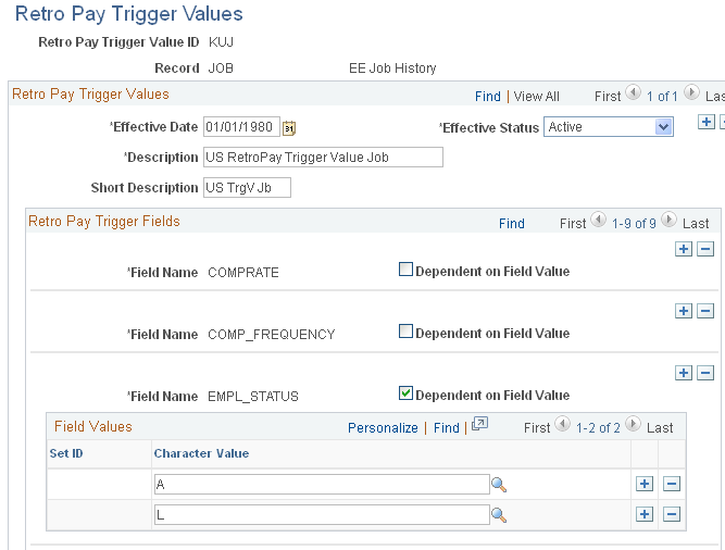

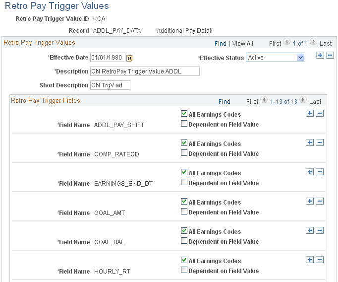

Use the Retro Pay Trigger Values page (RETRO_TRG_VALUES) to define a set of field changes that trigger retro requests. Each set can include fields from either the job record or the additional pay records.
Navigation:
This example illustrates the fields and controls on the Retro Pay Trigger Values page: JOB record.
This example illustrates the fields and controls on the Retro Pay Trigger Values page: ADDL_PAY_DATA record.
Field or Control |
Description |
Retro Pay Trigger Value |
This ID identifies the set of retro pay trigger values when you associate it with a retro pay trigger program. |
Record |
JOB and ADDL_PAY_DATA are the only supported records for trigger values. |
Retro Pay Trigger Fields
Field or Control |
Description |
Field Name |
Select one of the fields that the system is monitoring for changes. These are the fields that appear on the Retro Pay Monitored Fields page for the selected record. When you select a value, the Field Name field immediately becomes read-only. To change the value, you must delete the row and add a new one. |
Earnings Code and All Earnings Codes |
Note: These fields appear only for the ADDL_PAY_DATA record. Use these fields to choose which additional pay earnings codes produce retro requests when the selected field changes. To create retro requests for all retro-eligible earnings codes, select the All Earnings Codes check box. The system hides the Earnings Code field when the check box is selected. To create retro requests for a single earnings code, deselect the check box and enter a value in the Earnings Code field. To create retro requests for some, but not all, earnings codes, you can create multiple rows of data for the same field and enter different earnings codes for each row. Earnings code processing relies on the use of certain delivered codes that populate the Earnings Code field when you do not explicitly select a code. For JOB fields, the system uses the $NA (not applicable) earnings code, and for ADDL_PAY_DATA fields that affect all earnings codes, the system uses the $AC (all codes) earnings code. Therefore, it is critical that you do not modify, remove, or inactivate these two delivered earnings codes. |
Dependent on Field Value |
To create a retro request for any change to the selected field, leave this check box deselected. To create a retro request only when the field changes to one or more specific values, select this check box and enter the values in the Field Values grid that appears. |
Field Values
Field or Control |
Description |
Set ID |
If the selected field is setID-controlled, you must enter a setID before you can select specific values. If the selected field is not setID-controlled, this field is not editable. |
<Field Type> Value |
Enter the values that create retro requests. For example, in the JOB record, you might create retro requests for certain employee status changes to Active or Leave of Absence, but not when it changes to any other value. Depending on the field type, the label for the field value column is Character Value, Numeric Value, or Date Value. |

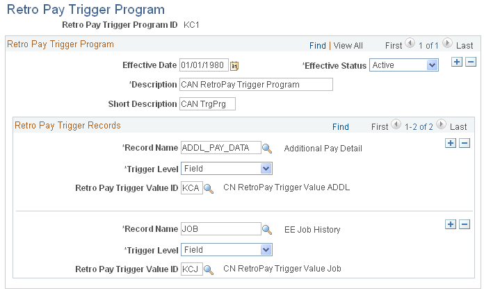

Use the Retro Pay Trigger Program page (PY_RETROTRG_DEF) to define a retro pay trigger program that encompasses up to two sets of triggers: one for the job record and one for the additional pay record.
Navigation:
This example illustrates the fields and controls on the Retro Pay Trigger Program page.
Field or Control |
Description |
Retro Pay Trigger Program ID |
This ID identifies the retro pay trigger program when you associate it with a pay group. |
Retro Pay Trigger Records
Field or Control |
Description |
Record Name |
Create rows for the JOB record and the ADDL_PAY_DATA record. These are the only records that support retro pay triggers. |
Trigger Level and Retro Pay Trigger Value ID |
Select Field as the trigger level. Selecting Field makes the Retro Pay Trigger Value ID field appear so that you can select the retro pay trigger value ID that identifies those specific field changes. Note: Do not select Record. Triggering retro pay based on record-level changes (a new row, or changes to any field) is not currently supported. |

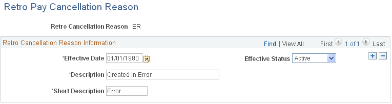

Use the Retro Pay Cancellation Reason page (PY_RETROCNL_TBL) to set up the cancellation reasons that users can use when manually canceling a retro pay request.
Navigation:
This example illustrates the fields and controls on the Retro Pay Cancellation Reason page.
Note: All fields are read-only when you view the SC (system generated cancellation), UC (cancelled by user), and ZR (zero retro - $0.00 to be paid) cancellation reasons.
