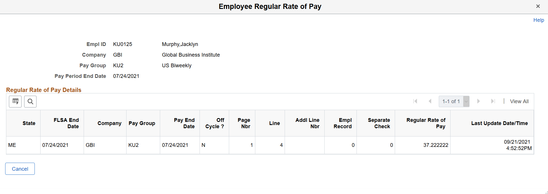

Example 2: Standard Calculation for Maine Employee Working Over 40 Hours a Week
In this example, the employee in Maine worked for 45 hours in the specified 7-day FLSA period. The selected calculation routine for Maine is Standard Calculation.
Maine is not set up on the Alternative Overtime State Table page. The employee's FLSA status is Nonexempt.
Pay Information
Value
Current Pay Period
July 11, 2021 – July 24, 2021
FLSA Period
July 18, 2021 – July 24, 2021
State
ME
Calculation Routine for State
Hourly Rate
35 USD
Regular Hours
45
Bonus
100.00 USD
Total Earnings for the Week
35 USD x 45 + 100 USD = 1675 USD
Regular Rate of Pay
1675 USD / 45 = 37.22 USD
The system calculates the employee's regular rate of pay because the number of total hours worked exceeds 40. The regular rate of pay is calculated by dividing the total earnings for the week by the total hours worked, which is 37.22 USD.
This example illustrates the calculated regular rate of pay for the FLSA period on the Employee Regular Rate of Pay page (example 2).
Calculated regular rate of pay for example 2

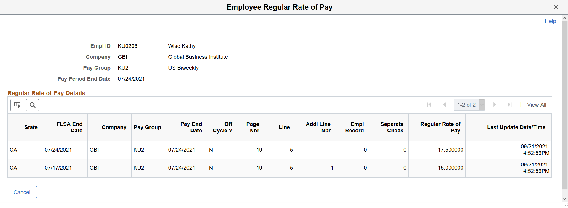

Example 3: Standard Calculation for California Employee Working 40 Hours a Week
In this example, the employee in California worked for 40 hours in each of the two 7-day FLSA weeks of the current pay period. The selected calculation routine for regular rate of pay for California is Standard Calculation.
California is set up on the Alternative Overtime State Table page. The employee's FLSA status is Nonexempt Alternative Overtime.
Pay Information
Value
Current Pay Period
FLSA Period
July 11, 2021 – July 17, 2021
State
CA
Hourly Rate
15 USD
Regular Hours
40
15 USD x 40 = 600 USD
Regular Rate of Pay
600 USD / 40 = 15 USD
Even though the number of total hours worked doesn't exceed 40, the system calculates the employee's regular rate of pay because the 40-work-hour rule doesn't apply when the state is specified in the alternative overtimes state table and the employee is in the right FLSA status. In the first week's example, the calculated regular rate of pay is 15 USD, same as the hourly rate.
Pay Information
Value
Current Pay Period
FLSA Period
State
CA
Hourly Rate
15 USD
Regular Hours
40
Bonus
100 USD
15 USD x 40 + 100 USD = 700 USD
Regular Rate of Pay
700 USD / 40 = 17.50 USD
In the second week's example, the employee had a 100 USD bonus and the calculated regular rate of pay is 17.50 USD.
This example illustrates the calculated regular rates of pay for both FLSA periods on the Employee Regular Rate of Pay page (example 3).
Calculated regular rate of pay for example 3

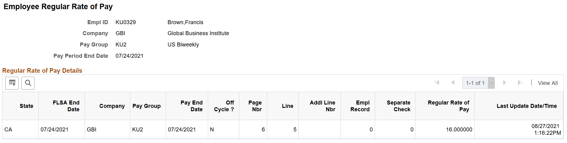

Example 4: Include Overtime Premium Calculation for California Employee Working 40 Hours a Week
In this example, the employee in California worked for 40 hours in the 7-day FLSA period, and had a flat sum bonus. The selected calculation routine for California is Include Overtime Premium.
Pay Information
Value
Current Pay Period
FLSA Period
State
CA
Hourly Rate
16 USD
Regular Hours
40
Flat Sum Bonus
100 USD
Overtime Premium
(Flat Sum Bonus / Regular Hours)
100 USD / 40 = 2.50 USD
Regular Rate of Pay
(Hourly Rate + Overtime Premium)
16 USD + 2.50 USD = 18.50 USD
The regular rate of pay is calculated by adding the hourly rate and overtime premium, which is 18.50 USD.
This example illustrates the calculated regular rate of pay for the FLSA period on the Employee Regular Rate of Pay page (example 4).
Calculated regular rate of pay for example 4

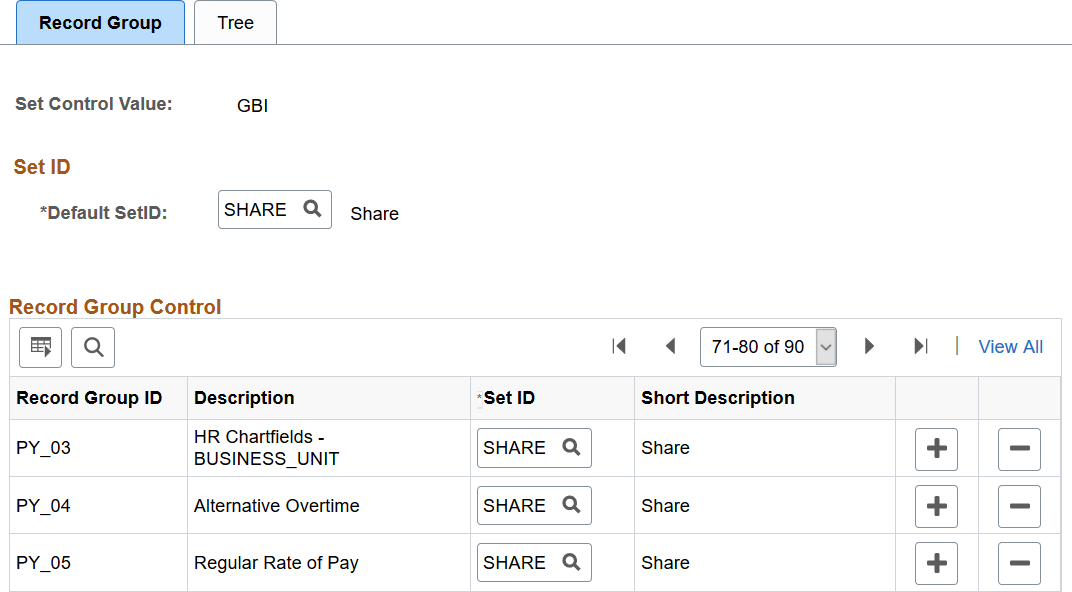

Here are the high-level steps for setting up the Regular of Rate Pay calculation.
  1. Select an setID for the PY_05 record group on the Record Group page (SET_CNTRL_TABLE1) to match the setID that you use for the regular rate of pay setup on the Regular Rate of Pay Control Page.
    This example displays the record groups and their setIDs for GBI on the Record Group page. The setID for the PY_05 record group is SHARE, the same setID that is also used in the regular rate of pay setup.
    SetID selected for the PY_05 record group on the Record Group page
