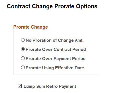

(E&G) Use the Contract Change Prorate Options page (JOB_CNT_CHG_SEC) to select contract proration options and enable the system to process a lump-sum payment of retroactive earnings to the employee.
Navigation:
Select the Contract Change Prorate Option link on the Compensation page.
This example illustrates the fields and controls on the Contract Change Prorate Options page.
Before running the process to calculate and report on lump-sum retroactive payments for contractual employees, set up the system at the employee level.
Select the Lump Sum Retro Payment check box on the Compensation: Contract Change Proration Option page.
