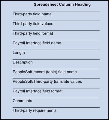

This graphic shows a spreadsheet you can use as a starting point to facilitate data mapping:
This graphic shows a spreadsheet you can use as a starting point to facilitate data mapping.
Note: Use the Payroll Interface field name to set up the interface file definition when you define the export/import file layouts.
