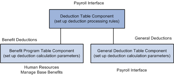

This graphic illustrates the relationship between the Deduction Table component, benefit deductions, and general deductions:
This diagram illustrates the relationship between the Deduction Table component, benefit deductions, and general deductions.

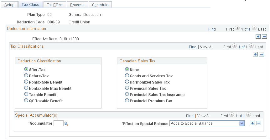

Use the Deduction Table - Tax Class page (DEDUCTION_TABLE2) to set up deduction tax classifications.
Navigation:
This example illustrates the fields and controls on the Deduction Table - Tax Class page.
Deduction Classification
Use this group box to select an appropriate tax classification for the deduction, including:
After-tax or before-tax for employee deductions.
Nontaxable benefit and nontaxable before-tax benefit for employer contributions.
A deduction can have more than one classification. However, it is still considered one deduction. For example, a benefit deduction plan, such as 401(k), can have both before-tax and after-tax classifications as well as a nontaxable classification for employer contributions.
Note: (USF) A retirement plan deduction, such as TSP benefit deductions, can have a before-tax and a nontaxable classification for any employer contributions. Certain benefits, such as FEGLI, will have an after-tax classification for the employee contribution. If your agency has a FEGLI plan that provides coverage in an amount equal to three times your base salary of 40,000 USD a year, you pay for the after-tax deduction.

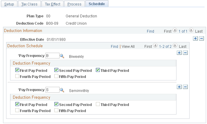

Use the Deduction Table - Schedule page (DEDUCTION_TABLE5) to set up deduction processing.
Navigation:
This example illustrates the fields and controls on the Deduction Table - Schedule page.
Deduction Schedule
By default, deductions are taken out every pay period regardless of pay frequency. Use this group box if you want a deduction to be taken out on a schedule other than every pay period.
Field or Control |
Description |
Pay Frequency |
Select the pay frequency that you want to override for those deductions that are not deducted every pay period. Values prompt from the Frequency table: Annual, Biweekly, Daily, Monthly, Quarterly, Semimonthly, and Weekly. If you select a weekly frequency, you can select the Fifth Pay Period option only if you have also selected the first, second, third, and fourth pay period options. Likewise, if you select a biweekly frequency, you can select only theThird Pay Period option if you have also selected the first and second pay period options. Because a deduction with a monthly frequency is always taken once a month, no override is available for a monthly frequency. Suppose you have a semimonthly payroll, but a health deduction should only come out of the last paycheck of the month. In this case, you would select a pay frequency of Semimonthly and take a deduction in the second pay period. |
Deduction Frequency
Use this group box to specify the appropriate pay periods in which to take the deduction for the selected pay frequency. You must insert a new row for every pay frequency for which you have a pay group defined.
Field or Control |
Description |
First Pay Period through Fifth Pay Period |
Select the appropriate pay periods that you want the deduction to be taken in. |
