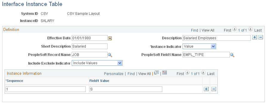

Use the Interface Instance Table page (PI_INSTANCE_PNL) to set up instance IDs to filter PeopleSoft data that is mapped to Payroll Interface fields or records.

This example illustrates the fields and controls on the Interface Instance Table page.
Definition
Field or Control |
Description |
Instance Indicator |
Select either:
PeopleSoft Record Name and PeopleSoft Field1 Name |
Select to identify the PeopleSoft record and PeopleSoft field that are tested against the specified values. |
Include Exclude Indicator |
Select to include or exclude the value when it matches the condition that you specified. |
Instance Information
Field or Control |
Description |
Sequence |
Select to indicate which occurrence or entry in the PeopleSoft record to use for processing. The sequence order is dictated by the select order on the primary PeopleSoft table used to define the interface ID field or record. When using an ordinal instance type, Payroll Interface selects only the occurrence that corresponds to the row number from the PeopleSoft record defined for export. |
Field1 Value |
Select to indicate a value to use during processing. To create an instance ID based on the value of zero, use the literal value ZERO instead of 0. To create an instance ID based on the value of space, use the literal value SPACE instead of pressing the space bar. |
