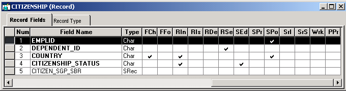

This example shows the Citizenship table (record):
This example illustrates the fields and controls on the CITIZENSHIP table (record).

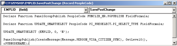

This example shows the PeopleCode that is required to activate Smart Select:
This example illustrates the fields and controls on the PeopleCode function UPDATE_SMARTSELECT.
