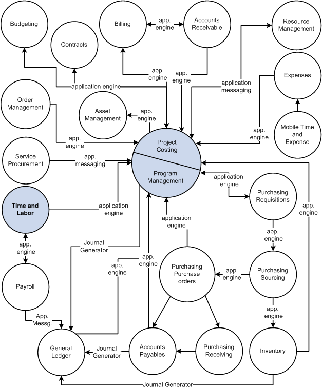

This diagram illustrates the process flow in Project Costing
