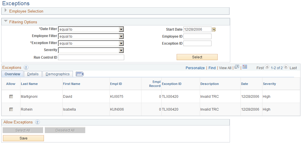

Use the Manage Exceptions page (TL_MNG_EXCEPT_PNL1) to review, allow, or clean up exceptions. The system displays up to 100 exceptions per page
Note: This page has been replaced by the Manage Exceptions page in Fluid. For more information, see Using PeopleSoft Fluid User Interface for Time Management as a Manager.
Navigation:
This example illustrates the fields and controls on the Exceptions page. You can find definitions for the fields and controls later on this page.
Note: You may view and allow exceptions with a status of Unresolved using this page. System delivered exceptions have a High severity level are not allowable. To view exceptions that have already been resolved or allowed, use the Exceptions History page.
Field or Control |
Description |
Employee Selection Criteria |
Enter values and click the Get Employees button to control which employee exceptions the system displays to approve or resolve. |
Filter Options |
Expand this grid to further control which exceptions the system displays. |
Filter Options
Field or Control |
Description |
Date |
Select a date filter for this exception: between, equal to, greater than, or less than. |
EmplID |
Select an EmplID filter for this exception: equal to, greater than, less than, or like. |
Severity |
Select a severity level filter for this exception: High, Low, or Medium. |
Exception ID |
Select an exception ID filter for this exception: equal to, like, not equal to, not like. |
Run Control ID |
Enter the value of the run control that was used when the exception was created. |
Exceptions Grid
Field or Control |
Description |
Allow |
Select the check box in this column to select an individual time reporter's exception to be allowed for that date. Note: If all the exceptions displayed on the page are not allowable, then the Allow column and Allow All button are hidden. |
Exception ID |
Displays the Exception ID code that was delivered with the system or that you defined using the Define Exceptions page. Click the Details tab to view the Exception Information details of the exception. |
Description |
Description of the exception. |
Date |
Displays the date of the reported time that caused the exception. |
Name |
Employee's name for the related exception. |
Severity |
Displays the severity of the exception: High, Medium, and Low. The system does not create payable time for reported time that has an exception severity of High .The system does create payable time for reported time with an exception severity of Low or Medium. Note: The system treats Low and Medium exceptions in the same manner. The Medium severity is primarily an administrative designation that enables managers indicate exceptions that require greater attention. |
Select All |
Click to select all the exceptions for the group to be allowed. This selects the Allow check boxes for all the exceptions displayed on the page. If you click this button again, the system clears the Allow check boxes. Once you have selected the exceptions you want to allow, click the Save button to allow the exceptions. The exceptions can then be processed through Time Administration to create payable time. Note: If all the exceptions displayed on the page are not allowable, then the Allow column and Select All and Deselect Allbuttons are greyed out. |
Deselect All |
Click to clear all selections made. |
Save |
Once you have selected the exceptions you want to allow, click the Save button to allow the exceptions. The exceptions can now be processed through Time Administration to create payable time. |

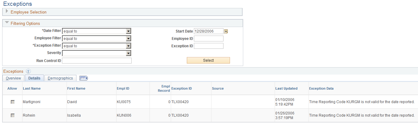

Click the Details tab.
This example illustrates the fields and controls on the Exceptions page - Details tab. You can find definitions for the fields and controls later on this page.
Note: The screenshot does not display all information on the page. Scroll to right on your screen to see the entire page.
Field or Control |
Description |
Exception ID |
The exception can be a system-delivered exception or one that you defined using the Define Exceptions pages. |
Source |
The source of the process that created the exception, such as Time Administration or Time Validation. |
Last Update Date Time |
Displays the date and time the exception was resolved or allowed. |
Exception Data |
Displays the message that contains the actual values that were entered that caused the exception such as "The reported TRC BNKR is invalid." |
Exception Description |
Click this link to view the long description for the exception. |
Comments |
Enter any comments about how or why the exception was allowed or resolved. |
Note: The remaining fields that display on the Details tab are the fields that have been selected on the Manager Search Options page.

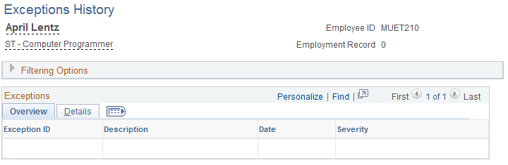

Use the Review Exceptions History page (TL_AUD_EXCEPT_PNL) to view exceptions that have been resolved or allowed.
Navigation:
This example illustrates the fields and controls on the Exceptions History page. You can find definitions for the fields and controls later on this page.
Field or Control |
Description |
Exception ID |
Click the link that appears in this column to view details of the resolved or allowed exception. |
Description |
Displays the description of the exception. This description is the exception text either delivered with the system or that you established when you set up your exceptions. |
Status |
Displays whether the exception was Resolved or Allowed. To view and allow Unresolved exceptions, use the Manage Exceptions page. |
Severity |
Displays the severity of the exception: High, , Medium or Low. The system will not create payable time or send the time to payroll if the exception severity is High until it is either allowed or resolved by the user. However, the system will create payable time for reported time with an exception severities of Medium or Low. |
The Exception ID link displays the same information as the Manage Exceptions Details tab.
Important! To view a particular exception on the Exceptions History page, you must first specify that you want the exception to be archived during exception setup. To do this, go to the Define Exception page, display the specific exception of interest, and select the Archive Exception check box. When the exception is generated and is subsequently resolved or allowed, it appears on the Exceptions History page.
The Filter Options page functions the same as the Filter Options on the Manage Exceptions page. See Manage Exceptions , Filter Options for a description of these fields.
