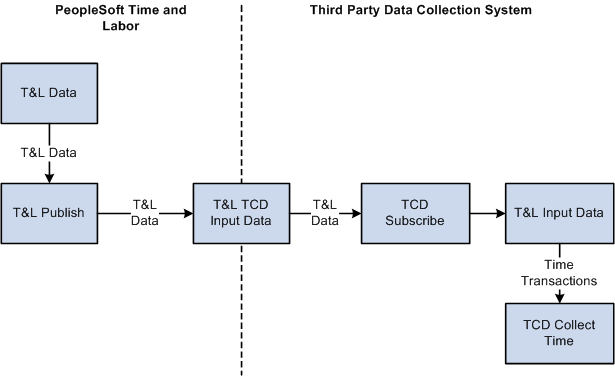

Time and Labor sends (publishes) setup data to your TCD in the form of messages associated with service operations. The publish process can be scheduled to run once or multiple times a day. All information contained in one set of published messages replaces the previously stored information at the TCD level. The date the system uses to retrieve TCD information is always the current date.
This diagram depicts how Time and Labor publishes information to your TCD
Incremental messages are sent when time reporter data changes in Time and Labor. Incremental messages are sent when you change:
Time reporter status.
The TCD group associated to the time reporter.
The elements in a TCD group.
You can send the published messages to all or selected message nodes/comm servers.

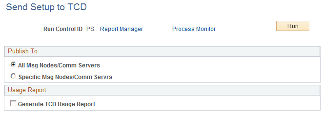

Use the Send Setup to TCD page (TL_TCD_RUN_PNL) to publish setup information for your TCD to retrieve from Time and Labor.
This page can also be used to Generate a TCD Usage report that sums up the number of elements transmitted to a TCD during time reporting. The TCD Usage report can be used to estimate the memory requirements of each TCD.
Navigation:
This example illustrates the fields and controls on the Send Setup to TCD page. You can find definitions for the fields and controls later on this page.
Field or Control |
Description |
All Msg Nodes/Comm Servers |
Select to publish the information to all your TCDs (message nodes). |
Specific Msg Nodes/Comm Servers |
Select to send to a specific message node, or TCD. |
Generate TCD Usage Report |
Select to generate a TCD Usage report for this TCD run. Select this check box if you want the system to generate a summary TCD Usage report for this TCD run. |
Include Detail |
Select to generate a detail report for all the values being sent for this TCD run. Only available if Generate TCD Usage Report is selected. |
Language Code |
Select the language the report will be printed in. |
Message Node Name |
Enter a TCD (message node) to send the data to. Only available if Specific Msg Nodes/Comm Servrs is selected. |
