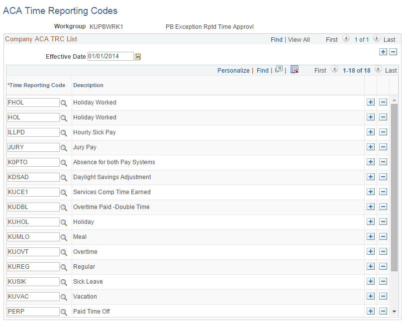

Use the ACA Time Reporting Codes page (ACA_TL_TBL) to define the Time Reporting Codes (TRCs) that are used to calculate the average number of hours for ACA eligibility.
Navigation:
This example illustrates the fields and controls on the ACA Time Recording Codes Page. You can find definitions for the fields and controls later on this page.
Field or Control |
Description |
Workgroup |
Specify a workgroup that the employee population uses which is subject to the ACA regulations. You need to define TRCs for all applicable workgroups. |
Effective Date |
The effective date of the defined group of TRCs. |
Time Reporting Code |
Specify all of the TRCs for calculating ACA eligibility for employees belonging to the workgroup. |

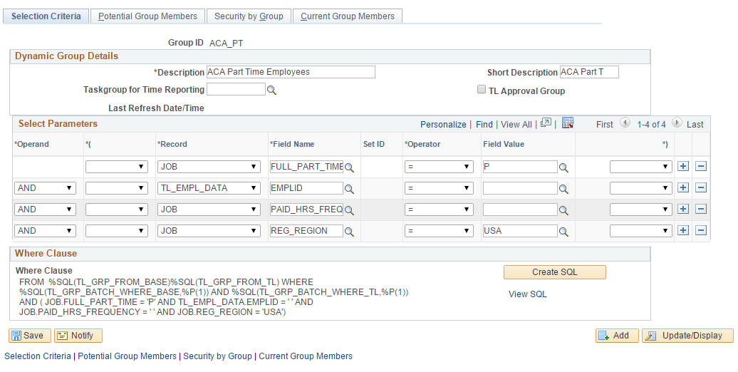

Use the Time and Labor Groups (TL_GROUP_D1) page to segregate your employee categories to which different measurement and stability periods are applied.
Note: Both static and dynamic groups have to be set up according to the need. This page description explains how to set up the dynamic groups.
Navigation:
This example illustrates the fields and controls on the Dynamic Group - Selection Criteria page.
Field or Control |
Description |
Group ID |
Taskgroup for Time Reporting |
This allows the separation of employee populations using the following categories:
salaried employees and hourly employees
employees whose primary places of employment are in different states
collectively bargained employees
non-collectively bargained employees
each group of collectively bargained employees covered by a separate collective bargaining arrangement.
